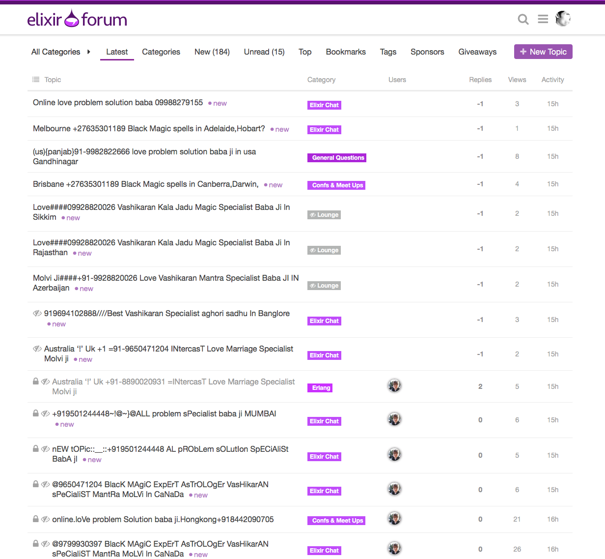

Are there any patterns to this spam? Can you paste a few example screenshots ?
Yeah we need a lot more info on this. Was it multiple users? There are so many rate limits in Discourse, I’m hard pressed to think how 100 topics could be created.
Unless you have changed the defaults, there are a lot of defaults you can change that can cause serious exposure to spam.
Here are a few of them Sam:
Full text:
They even uploaded an image and used tags:
Some of them are just plain daft:
So quite varied.

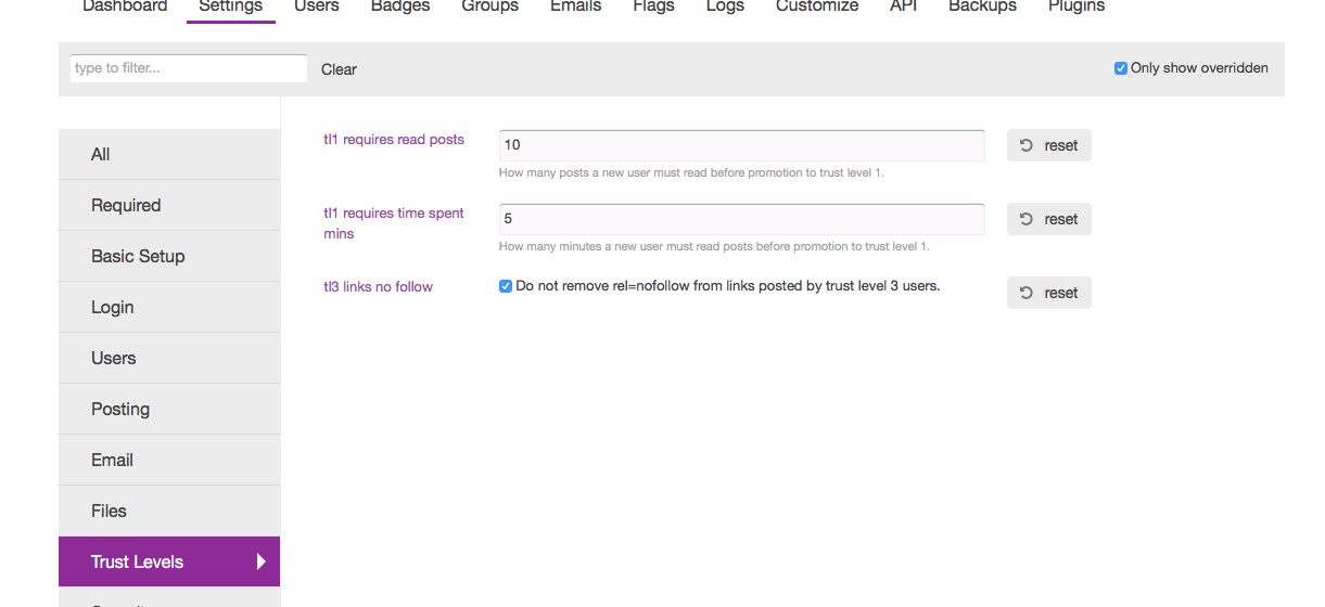

I believe the only thing I modified was the number of links TL0 can post, but let me check…
Trust Levels > only overridden:
I’d need to see all overridden settings to verify. Rate limiting in particular. The main thing to look at is, how many users posted these topics?

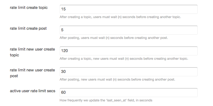

Haven’t changed any rate limits..
Here are overrides for applicable sections:
(note user spam threshold was higher - have just reverted it (tho no difference to this spam as they didn’t post links))

Judging by the number of posts, this looks like human spammer that went around first to get TL1.
You should revert TL1 to default (you made it 1/3 of the default) and pay/configure/use Akismet.

I think I made some of these changes because when we first started lots of genuine members posts were going into moderate/needs approval and I wanted to try and get people into it smoothly.
Ok @Falco I have reverted TL1 settings :slight_smile:
