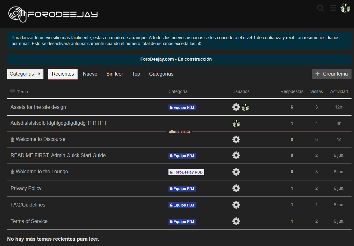

Hello ,
How can i add different logos for booth theme ?
I mean , for black theme a white logo (i have it already)
But for the light theme , a black logo ?
Black theme :
Light theme:
Also , is there any option to add a button for night/day mode in index , to change the theme ?

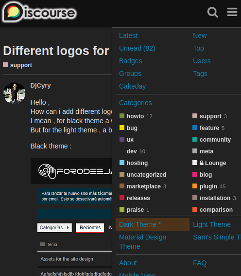

Try changing the theme here - note that there’s a partial white background included in the logo. You could do the same with an off-black background.
edit: Screenshot

cpradio
(cpradio)
24.Сентябрь.2017 22:37:14
If you check the “Theme can be selected by users” checkbox in Admin > Customize, it will show up as a link in the Hamburger menu.

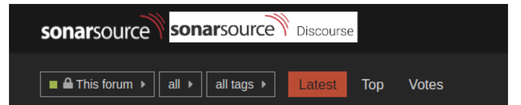

Am getting reports on our instance that @sam techniques (css trick ) no longer works, and instead leads to double logo:
Is this a regression ? Any recommendation to mitigate this ?

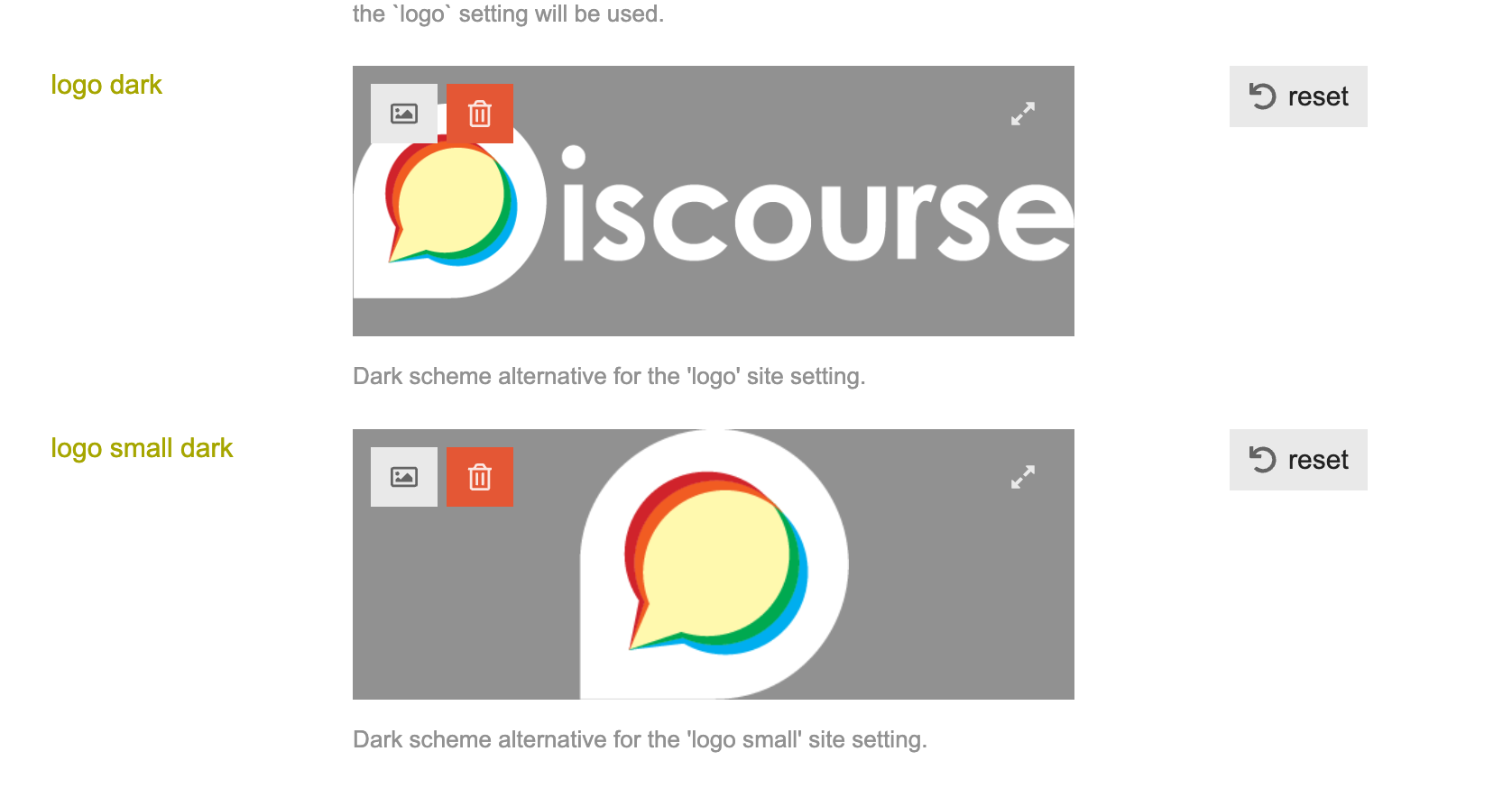

Теперь вы можете загружать версии логотипа в «тёмном режиме» в настройках сайта. Просто перейдите на вкладку «Брендинг» и прокрутите вниз до пунктов «logo dark» и «logo small dark»:
Более подробная информация здесь:
