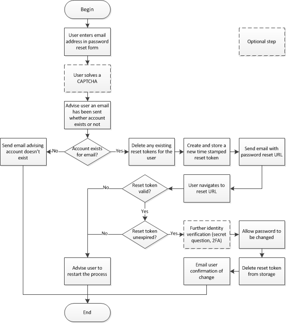

The alternative he proposes is sending an email to the “bad” or “incorrect” address, (assuming the user entered an email..) letting them know that the email has no account on the site.
This means you have to severely rate limit the password reset dialog, which we may want to do anyway.

Per Troy Hunt: Everything you ever wanted to know about building a secure password reset feature
