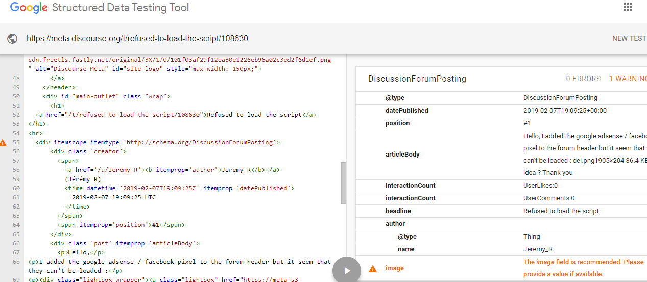

I have found one image error in schema testing tool as below.

No. Currently I am not sure about this change 100%. I’m unable to find any resource that recommending Comment schema type for reply posts.
Not error. It is just a warning. Google recommending the image field if available.
It is a required field.
