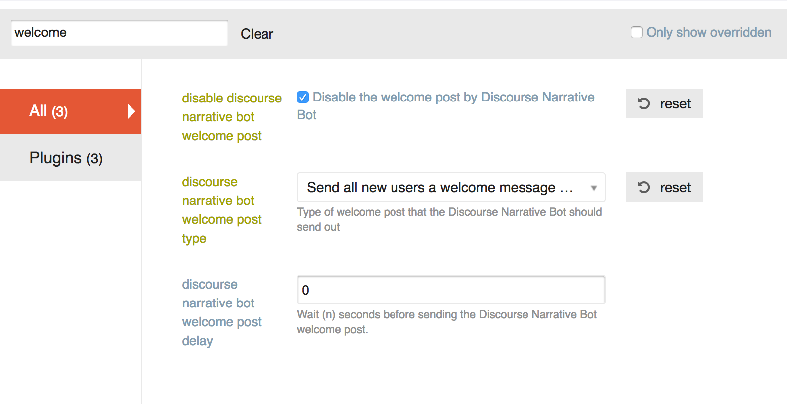

Hello. I’ve tried disabling these in a bunch of ways:
I’ve tried both choices for “discourse narrative bot welcome post type”, and the email sends no matter what.
I’ve also tried doing this:
The email is still being sent. How do I stop it?
Having a similar problem with the “Confirm your new account” email – the PM from discobot is turned off, but users are still receiving the email. It looks like these are different settings. Is there a way to remove the confirmation email?
