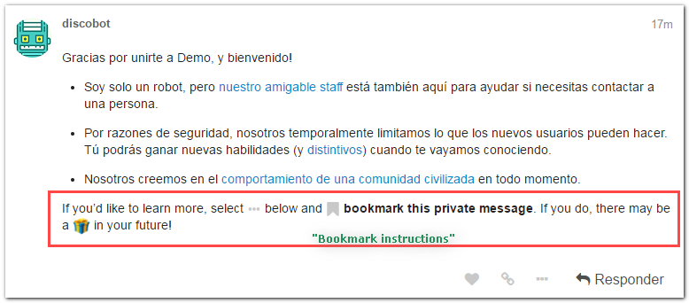

But, tested now on try.discourse.org and I saw:
Ps. The interface discobot was set on “es” language selection. :es:

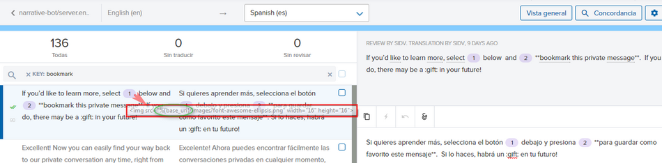

Si quieres aprender más, selecciona <img src="/images/font-awesome-ellipsis.png" width="16" height="16"> debajo y <img src="/images/font-awesome-bookmark.png" width="16" height="16">  **guarda como favorito este mensaje privado**. Si lo haces, quizás haya un :gift: en el futuro!
Something wrong in your translation, you lost the URI, see:
<img src="%{base_uri}/images/font-awesome...
@SidV I downloaded the narrative.bot.yml from transifex (version Spanish/Spain)
It seems that this version is not up-to-date, the strings are old, in fact the string for the bookmark is completely missing.
A quick fix is to upload the original file from github to transifex.
(and don’t forget to fix the URI that you lost)

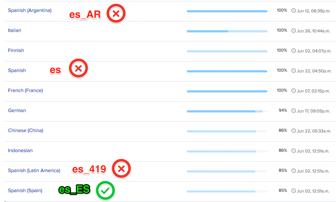

@neil se provi a confrontare la versione es da GitHub con la versione es da Transifex, vedrai la differenza (molte stringhe mancanti su GitHub)
So… Spanish means a lot of things: es_ES, es, es_AR, es_419, es_EC
Discourse has only ever supported one: es_ES.
https://github.com/discourse/discourse/blob/master/.tx/config#L3
But looking at Transifex, I see all these other translations that aren’t used by Discourse. Translators are doing a lot of work for nothing…
When Transifex integration was being setup, es_ES was the one. I don’t know why it was chosen since it was entirely up to the translators. Since all these other Spanish translations are being maintained, we can take pull requests for them. But the “es” translations are probably useless since we’re already mapping the es_ES ones to es. From what I remember, Rails i18n doesn’t recognize “es_ES”, which is why it had to be mapped to “es”. I’m not sure if es_AR and es_ES will work.
Great ! Let’s replace es_ES version with es files.
But… at interface preferences, when a user search “pt” (for example), has got two options: pt and pt_BR
If a spanish user search “es”, did not find es_ES:
That’s reason is why I spent a lot of time translating “es” version at transifex.
Now you said to me that this version is not the correct one. OK, I’ll replace the transifex files from “es” to “es_ES”.
And all happy, IMO, when we finish this, this “es” version should be deleted from transifex.
