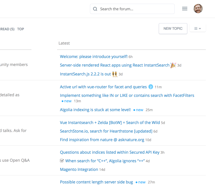

I’ve recently created a plugin that indexes topics, posts, users and tags with Algolia and combines them into a multi-category autocomplete search. Here’s a GIF of how it works:
You can find the Github repository, complete with installation instructions, on github at algolia/discourse-algolia.
Plugin configuration just requires populating a few fields. Indexing tasks are put in the jobs queue after objects are saved. Note: you will need to create an Algolia account, which is free up to 10,000 records.
