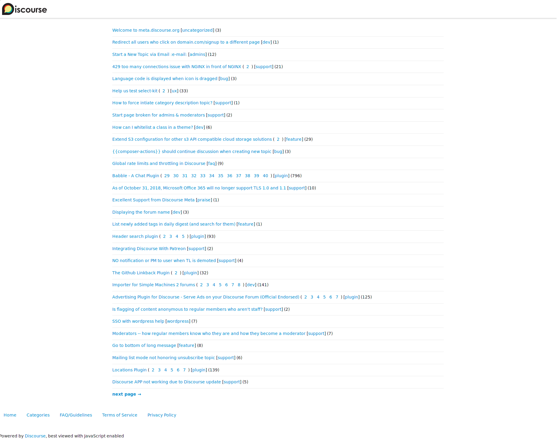

I have a slight issue with Discourse forums and Pale Moon browser (any OS, all versions).
Please look at attachment.
This issue started happening after january 20 somewhere, and seems a js issue as I get
Powered by Discourse, best viewed with JavaScript enabled. - Yes I have js enabled.

it looks like Discourse classifies your browser as a bot. Bot detection has been improved at the beginning of January: Smarter handling of random crawler traffic
Did you override the user agent in your browser? What’s the user agent shown at http://www.whatsmyua.info/ when you visit it with your Pale Moon browser?

Ah I see. Thank you for explaining it to me. Will you whitelist Pale Moon in the future?
user agent show:
## According to [useragent](https://github.com/3rd-Eden/useragent) v2.1.9:
- rawUa: Mozilla/5.0 (X11; Linux x86_64; rv:3.4) Goanna/20180208 PaleMoon/27.7.2
- family: Pale Moon (Firefox Variant)

This is how we detect if something is not a crawler:
Since I can not see “Goanna or Palemoon” in here: trident|webkit|gecko|chrome|safari|msie|opera you are not being detected as a real browser.
Traditionally all browsers ship the pedegree with the user agent string:
https://twitter.com/potch/status/963581752852717568
After reading Goanna (software) - Wikipedia I guess I am ok to add goanna to our magic string.
Trouble though is it sends a message that we support this Firefox fork, which we do not

Opera, at least the old one with the Presto engine, isn’t officially supported either. Yet it’s on the list.
I guess it is technically correct this is not a bot or crawler, so we can add an exception here.
https://github.com/discourse/discourse/commit/7af9ed66746536a51ee91da230514fab2be98293
