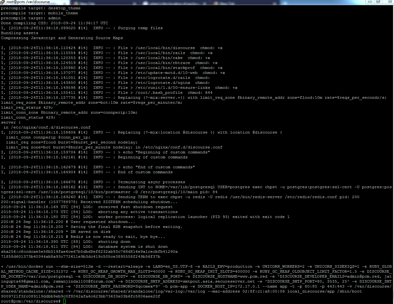

PFA the final installation screenshot of the console, where installed.

Does the output of ping www.pcm.red match your droplet’s IP?
I’ve curled your domain and it doesn’t respond with any HTML.
