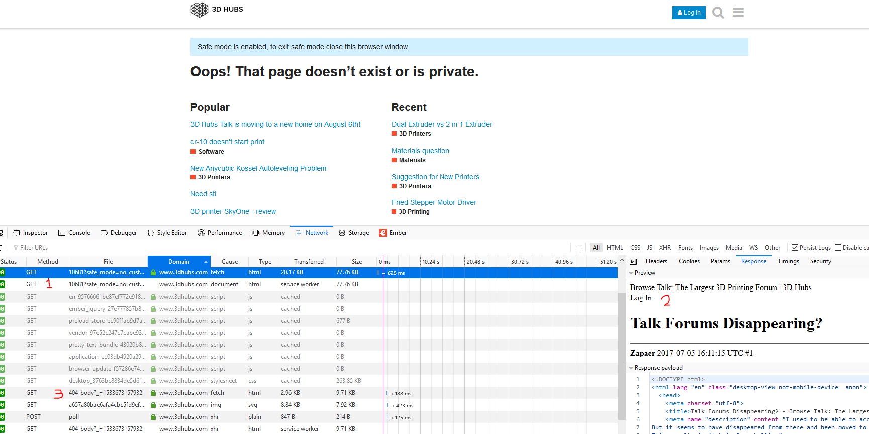

Some help from my hosting:
Weird bug indeed. I don’t see where it redirects either, seems to be returning the correct page and then redirected by Javascript. It’s not the nginx config, it is reaching the application server.
Using safe mode to make sure there is no plugin or theme causing this
1 - correct link is requested
2 - correct content is returned
but then:
3 - fetching 404 body
logging
[db5060] Started GET "/talk/t/talk-forums-disappearing/10681?safe_mode=no_custom%2Cno_plugins%2Conly_official" for 77.163.254.28 at 2018-08-07 20:19:10 +0000
[db5060] Processing by TopicsController#show as HTML
[db5060]   Parameters: {"safe_mode"=>"no_custom,no_plugins,only_official", "slug"=>"talk-forums-disappearing", "topic_id"=>"10681"}
[db5060]   Rendering topics/show.html.erb within layouts/application
[db5060]   Rendered topics/show.html.erb within layouts/application (6.3ms)
[db5060]   Rendered layouts/_head.html.erb (0.3ms)
[db5060]   Rendered common/_discourse_stylesheet.html.erb (0.1ms)
[db5060]   Rendered common/_special_font_face.html.erb (0.1ms)
[db5060]   Rendered application/_header.html.erb (0.2ms)
[db5060]   Rendered common/_discourse_javascript.html.erb (0.3ms)
[db5060] Completed 200 OK in 124ms (Views: 9.0ms | ActiveRecord: 26.0ms)
[db5060] Started GET "/talk/404-body?_=1533673157932" for 77.163.254.28 at 2018-08-07 20:19:12 +0000
[db5060] Processing by ExceptionsController#not_found_body as HTML
[db5060]   Parameters: {"_"=>"1533673157932"}
[db5060]   Rendering exceptions/not_found.html.erb
[db5060]   Rendered exceptions/not_found.html.erb (15.3ms)
[db5060]   Rendering html template
[db5060]   Rendered html template (0.0ms)
[db5060] Completed 200 OK in 52ms (Views: 0.3ms | ActiveRecord: 11.6ms)
إعجاب واحد (1)

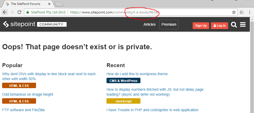

That fix is not ideal… @neil can you have a look at this issue
It does not make sense to me cause this topic works just fine:
I wonder if something is not configured right on your end Bram.
but… but… it doesn’t:
4 إعجابات
well it was working earlier for some crazy reason, @neil will look at this
إعجاب واحد (1)
It works fine when you browse to such a topic, it only fails when you come from a direct URL.
I agree, it might be better to restructure the code to not require this functionality at all but it does make the function do what it is supposed to do:
    Returns the current `location.pathname` without rootURL
Instead of just replacing every occurrence of Discourse.BaseUri with an empty string my version only drops the baseUri when it exists on the start of the url. The only case that this will break is when you decide to use any of the starts of system paths (/u, /t, /admin, etc) as your BaseUri. This will break your site, but not more then before.
I pushed a fix that looks only at the beginning of the path which avoids this problem. Unless you use /t, /u, or something like that, but that would be a terrible idea for many reasons.
