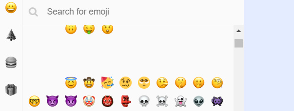

There is a problem though with my setup: it seems outer nginx is rate-limiting the emoticons box:
cat /var/log/nginx/error.log
2018/09/05 18:03:51 [error] 32008#32008: *235 limiting requests, excess: 20.295 by zone "flood", client: 193.186.16.206, server: chat.tbp.land, request: "GET /images/emoji/apple/strawberry.png?v=6 HTTP/2.0", host: "chat.tbp.land", referrer: "https://chat.tbp.land/"
2018/09/05 18:03:51 [error] 32008#32008: *235 limiting requests, excess: 20.295 by zone "flood", client: 193.186.16.206, server: chat.tbp.land, request: "GET /images/emoji/apple/pear.png?v=6 HTTP/2.0", host: "chat.tbp.land", referrer: "https://chat.tbp.land/"
What i did with the limit zones was place them inside the http context, and not in server, but i don’t think that’s a problem as limit_req can be placed in http.
Did i miss anything by any chance?
