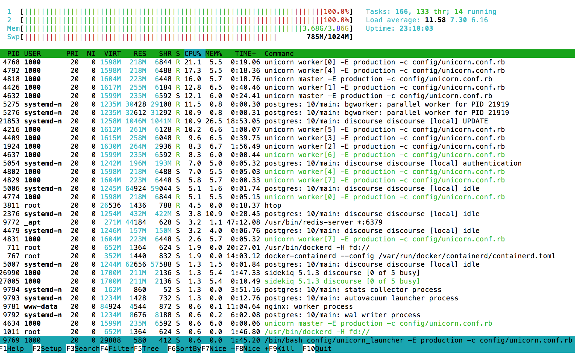

I have been running an instance of Discourse for the last 2 years with Digital Ocean without any problem but since the last 2 weeks, it became very slow or unavailable most of the time.
I have upgraded my hosting to the following one, it’s a bit better but still facing the same problems:
  • Ubuntu 14.04 x64
  • 2 vCPUs
  • 4GB / 80GB Disk
This is the output of the htop command:
Any idea where to start fixing this problem? Thanks a lot for your help.
What’s the %iowait? In general, htop is a poor substitute for top for actual diagnostic purposes.
top - 04:41:15 up 1 day, 25 min,  1 user,  load average: 6.32, 7.70, 6.89
Tasks: 162 total,   4 running, 158 sleeping,   0 stopped,   0 zombie
%Cpu(s): 64.2 us, 19.9 sy,  0.0 ni,  6.9 id,  7.7 wa,  0.0 hi,  1.3 si,  0.0 st
KiB Mem :  4048268 total,   116444 free,  2742964 used,  1188860 buff/cache
KiB Swap:  1048572 total,   451544 free,   597028 used.    68040 avail Mem
Given the 1m load average is nearly half what it was in the previous screenshot, and %iowait is still pretty high, I’d say you’re probably I/O constrained, likely due to swapping. Confirm with sar -W 1 whilst the system is at peak unhappiness, and then upgrade RAM.

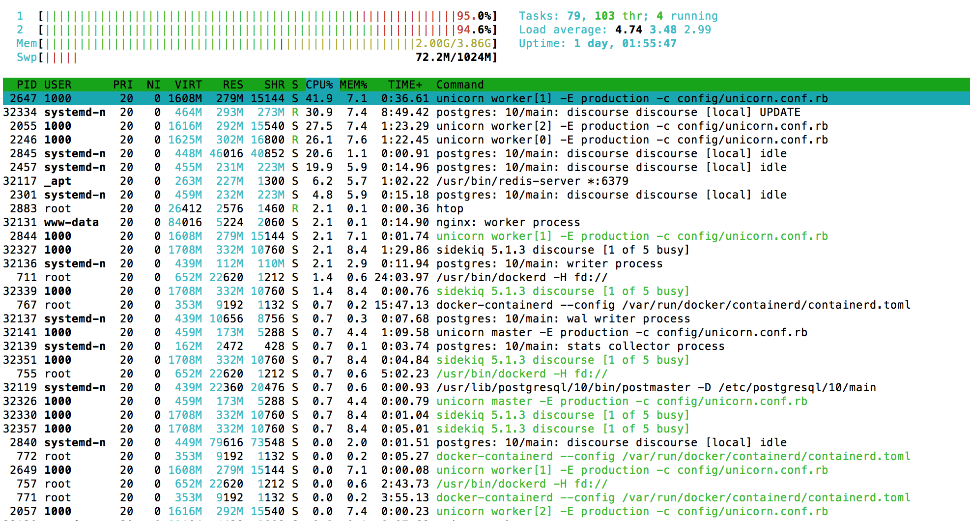

So after 2 hours and around 30 users live:
top - 06:11:09 up 1 day,  1:55,  1 user,  load average: 4.09, 3.24, 2.91
Tasks: 130 total,   7 running, 123 sleeping,   0 stopped,   0 zombie
%Cpu(s): 62.5 us, 26.4 sy,  0.0 ni,  1.4 id,  7.4 wa,  0.0 hi,  2.3 si,  0.0 st
KiB Mem :  4048268 total,   135872 free,  1739644 used,  2172752 buff/cache
KiB Swap:  1048572 total,   975084 free,    73488 used.  1763862 avail Mem

It’s still super slow, and I keep having errors 502 on my side when I try answering a message. Some messages can be posted though.
