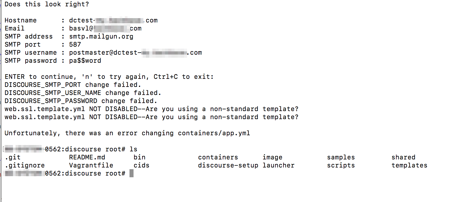

I get the following errors if I follow the tutorial to the letter (skipping letsencrypt) on Mac OS Sierra after running ./discourse-setup
Any idea what can cause this?
DISCOURSE_SMTP_PORT change failed.
DISCOURSE_SMTP_USER_NAME change failed.
DISCOURSE_SMTP_PASSWORD change failed.
web.ssl.template.yml NOT DISABLED--Are you using a non-standard template?
Any help would be appreciated.
Reason for installing docker locally is that I want to try to get some custom plugins in docker running locally before I push them to production.

My guess is that there is some compatibility with Mac sed. Sorry about that.
It has nothing to do with let’s encrypt. The problem is that sed isn’t doing the replacements that it’s trying to do.
Your best bet is to edit app.yml with vim or nano.
The intention around easy setup is very specifically for easing cloud based installs, not for local dev on a mac.
I would use docker for local dev in this way https://github.com/discourse/discourse/tree/master/bin/docker
