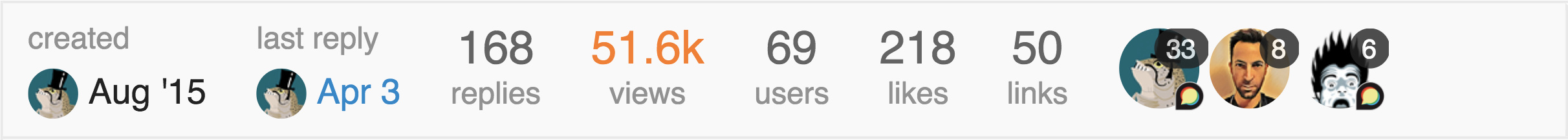

Related to discussions on embedding discourse comments into word-press sites and the discussion on “Embedding Discourse Comments via Javascript”, I am curious if you could advize me on embedding a topic topic-map into a another website?
I seem to recall readiing that topic-maps are not generated until at least one reply occurs. So, perhaps I am making a different request, asking for advice to embed a widget with a similar set of summary information that could be embedded off-site.
Why?, I desire to embed comments on off-site pages with limited space. Rather than the current embedding option that shows a list of comments, I feel these topic-maps are efficient summaries of discussion.
My goal would be a widget that looks something like:
Discuss this post at discourse.example.com
Topic-map examples:
Expanded:
