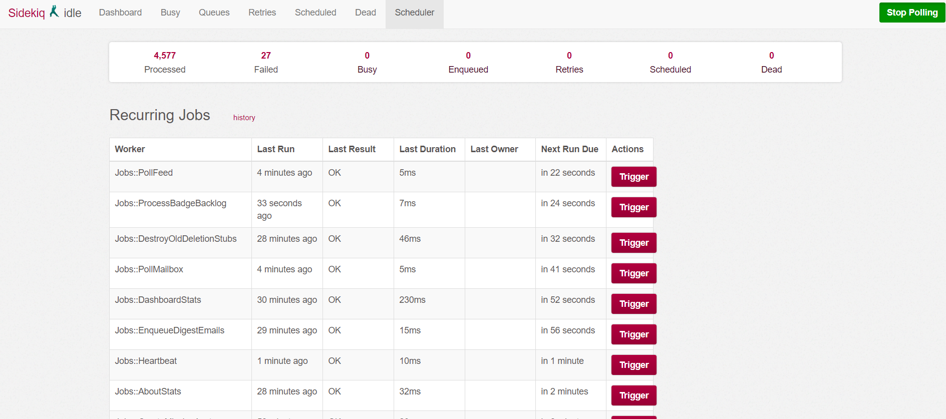

Can you show us the page when you click on the Scheduler tab?
Looks like it’s running properly (Last Result column has plenty of “OK” and Last Run column has recent dates)
I entirely rebuild my instance, still it is there :sadpanda:
When’s the last time the job "Jobs::VersionCheck " ran? (you can see that in the “Scheduler” tab)
It should be less than 24 hours. If not, then click the Trigger button on the same row.
