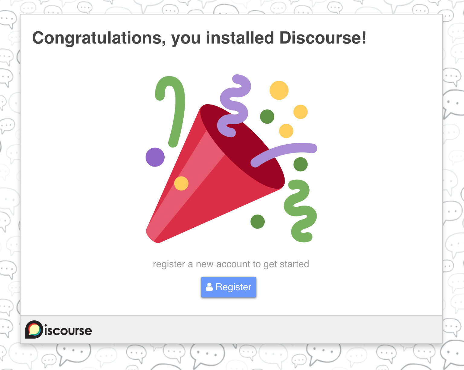

Does appear during an install, but the build succeeds.
That’s the full recommended install, with domain name specified (IP address based install not supported), SMTP details provided, and Let’s Encrypt enabled.
