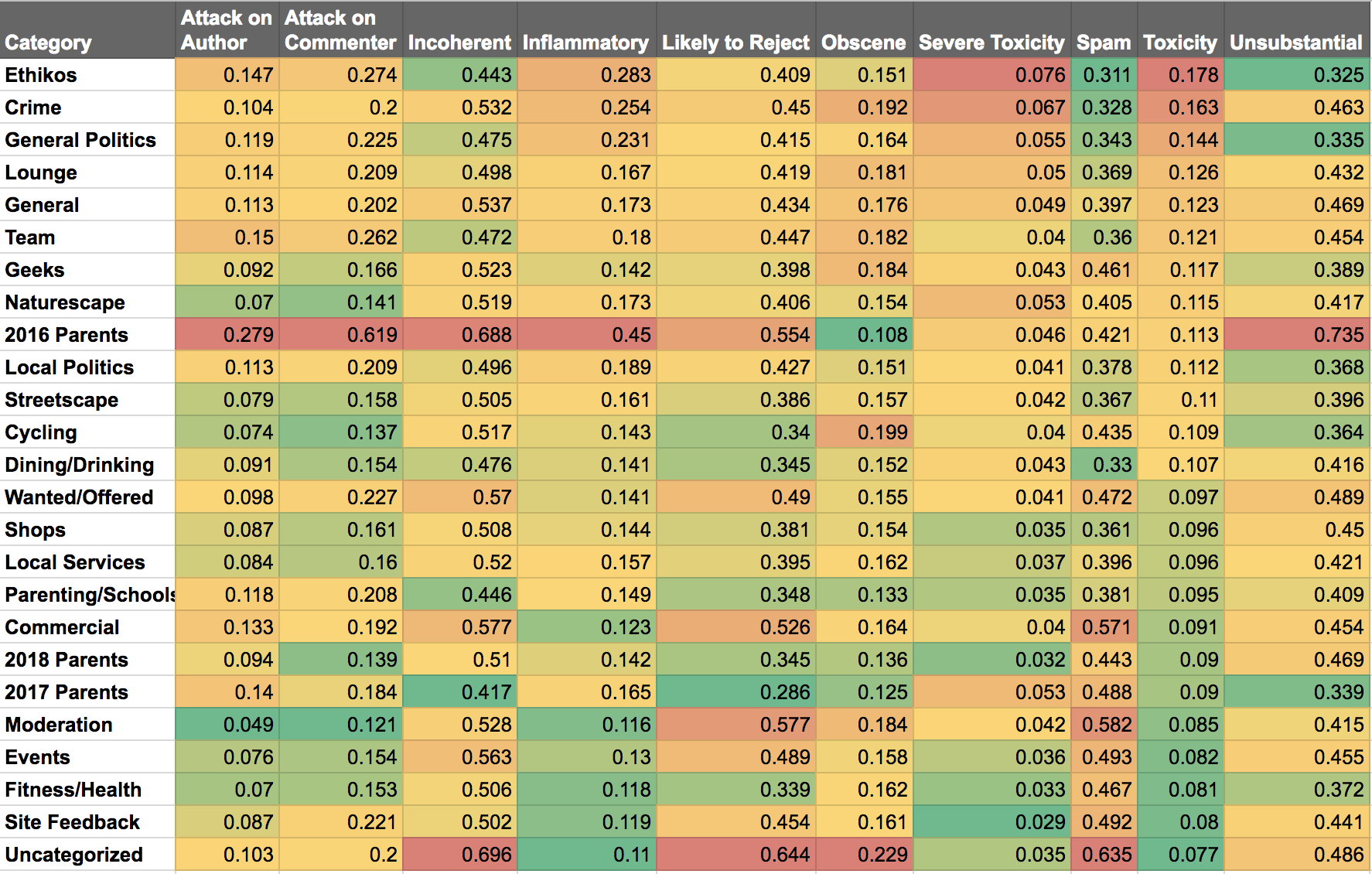

Here are the stats by category on my forum - seems mods urgently need to check out “2016 Parents” (an opt-in category) and work out what’s going wrong there!
As I imagined, most of the toxicity happens in our ethics and politics categories.
Here are the overall scores for SE23.life
Attack on Author 0.1
Attack on Commenter 0.19
Incoherent 0.505
Inflammatory 0.175
Likely to Reject 0.412
Obscene 0.165
Severe Toxicity 0.045
Spam 0.382
Toxicity 0.116
Unsubstantial 0.41
