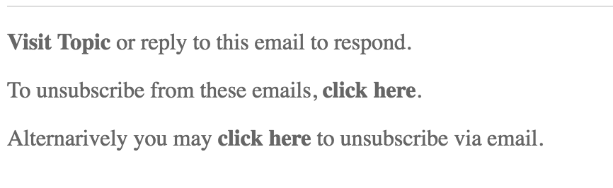

As part of the MOSS grant outlined here, I’ve been asked to write up a spec for unsubscribing from a topic via email.
Current behaviour: Unsubscribe via email is allowed, but requires a logged in user
Proposed behaviour:
Unsubscribing while logged in as any user will remain the same.
When logged out,
Clicking this:
Will take the user to a screen like this:
「いいね!」 3

I think this is the correct topic for this. I just noticed there is an unsubscribe by email option on the footer.
That second one defaults to a link like this for my site:
reply@community.namati.org
I don’t have that email address configured on my mail system. In fact I don’t have email on community.namati.org at all. Is there an admin setting (which I looked for and did not find) for setting up a working email address?
「いいね!」 4
I honestly wonder if we really need unsubscribe via email like this on every footer in light of my changes, it is just extra clutter. Will remove
