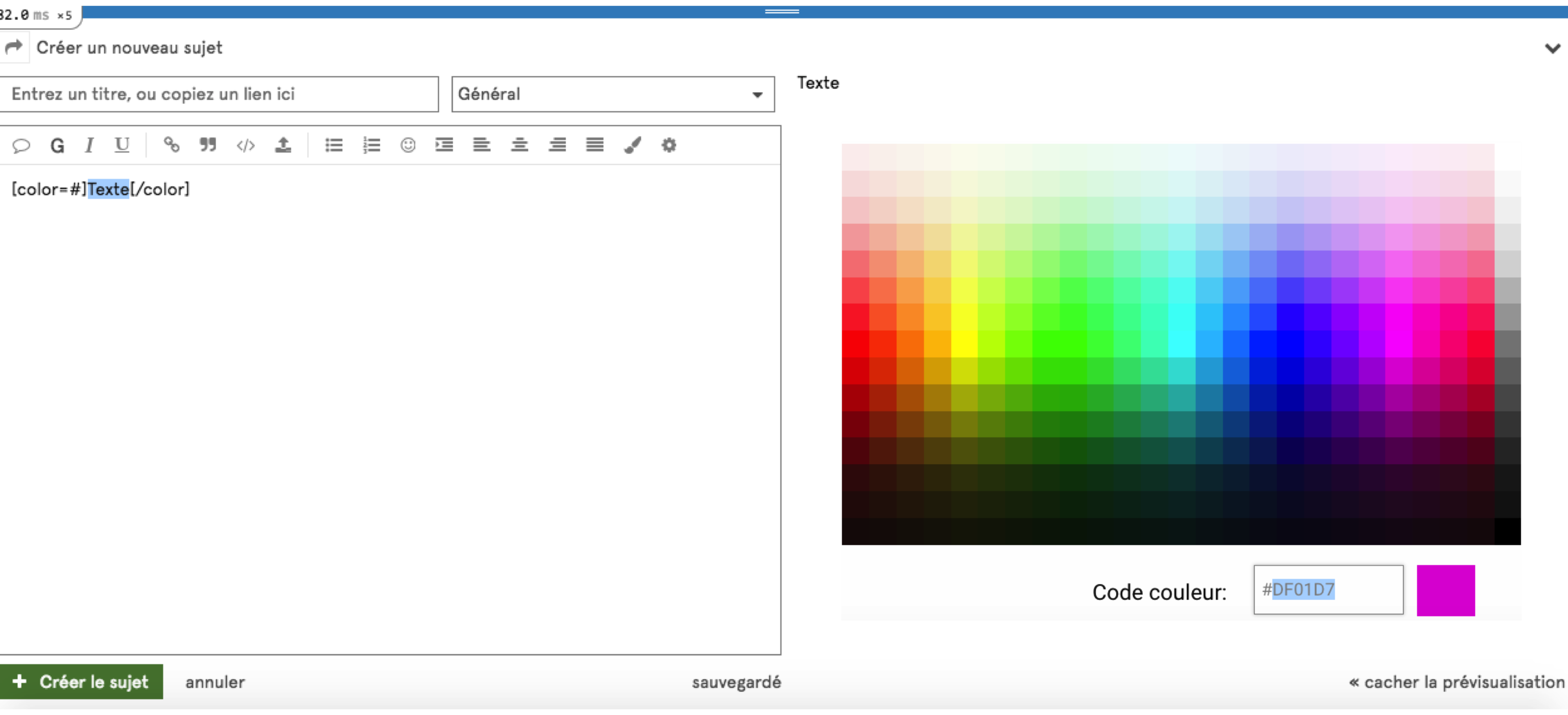

Also, do you think it’s possible to show something like that when someone wants to change colors?
With the latest option (we can choose which buttons can appear), I can add the size button, it’s a good idea, I’ll make an update very soon. It will be hidden by default I think.
For the color window, it’s above my capability to be honest. If someone can do something like this, I know there are a lot of people interested, I’ll gladly accept any pull request :pray:
