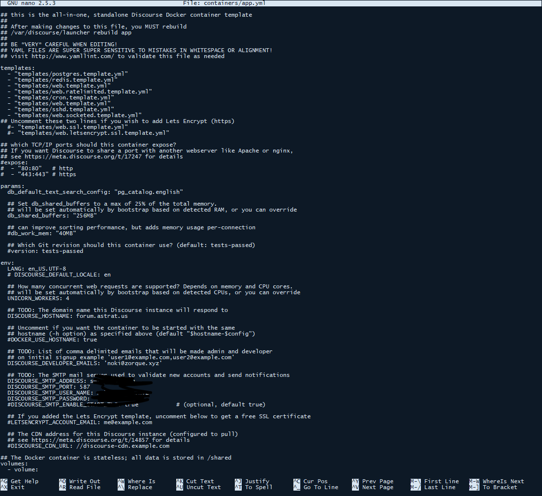

Looks like that would be your issue - you have nothing in your /containers/app.yml file
This is the content of /var/discourse/containers/app.yml (obviously blurred out password). It’s definitely been filled out.
edit: I should say, I coped this from samples/standalone.yml and changed domain settings, along with email settings and commented out the expose section for the sake of nginx.
The templates at the beginning of your app.yml look wrong. You have duplicates in there and the order is probably important too. Take another look at the guide you linked.
I’m running a similar setup (behind an nginx proxy), but in my app.yml I’m using the web.template.yml and web.ratelimited.yml template (which you have listed twice), but not the web.socketed.template template. Also I’ve un-commented the expose: block, and set discourse’s ports manually:

Thanks. I completely thought that portion of it was fine. Guess I didn’t look hard enough. Thank you all for your help.
