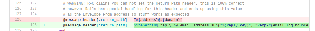

I’m not sure where this issue arises but I think this commit is causing me some hassles:
https://github.com/discourse/discourse/commit/84d4ebd9108cbe6c2d948401013ef869160fe666
What my site config has is an smtp account with noreply@mysite.com
My reply address in settings is forum@mysite.com
This was working correctly and people were able to reply to emails.
When I upgraded I get errors on mail being rejected as the from address is not being found in aliases, presumably because email is being sent by user noreply@mysite.com but with envelope from forum+verp{key}@mysite.com.
May 11 01:45:32 mail postfix/submission/smtpd[621]: NOQUEUE: reject: RCPT from unknown[x.x.x.x]: 451 4.3.0 <forum+verp-2b5431831091aec1bc4e1ba25b4c26cc@mysite.com>: Temporary lookup failure; from=<forum+verp-2b5431831091aec1bc4e1ba25b4c26cc@mysite.com> to=<some_user@gmail.com> proto=ESMTP helo=<localhost.localdomain>```
How do I resolve this?

Thanks this is the bit of code:

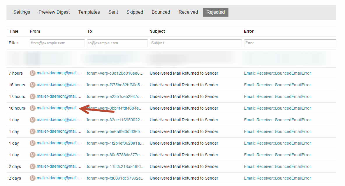

Just a follow up from this because:
smtp account = notification email = reply email I see the following:
All the bounced replies are going to the rejected queue for forum replies. This is a blessing and a curse. A blessing because I can see the bounce reasons to diagnose email issues. A curse because the rejected queue is supposed to be for rejected attempts at reply.
It also results in a :ghost: user being created:
I prefer if the bounced email list also contains a box to view the bounces. These should be separate from the failed reply by email emails where the bounced emails are now also landing.
Perhaps @zogstrip can advise here.
I agree, here’s a fix :wink:
As for the :ghost: user (we call them “staged users”), that’s standard procedure for all incoming emails.
