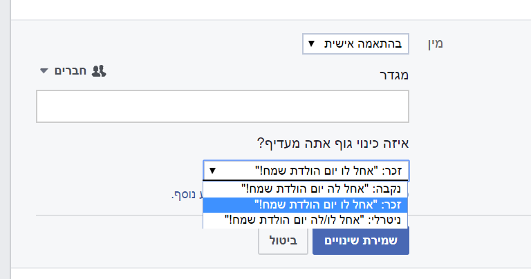

How does Facebook work if you provide no gender or specify not traditional male / female gender? What does it do then for translations that are gender specific?
Facebook allows you to pick
Sex:
  • Male
  • Female
  • Other, which then allows you to dig in to another checkbox that lets you pick what others will target you with, including forcing neutral language on others when talking about you and liking your stuff.
When you pick other you can select a sex between male and female if you wish, loosely translated the word they use is “category of people” you belong to and you can be in many.
The Other option means the UI in Hebrew is in kind of robot speak.
The most similar example in English would be: “1 car/s” and “2 person/people”, it technically works but is Robot Speak ™
What are you (male/female) thinking about (male/female)?
@Falco does portuguese on Facebook do the same?
(an aside, pluralization in hebrew is mega annoying cause it can be “many male”, “many female” and “many male” if the group contains both male and female members)

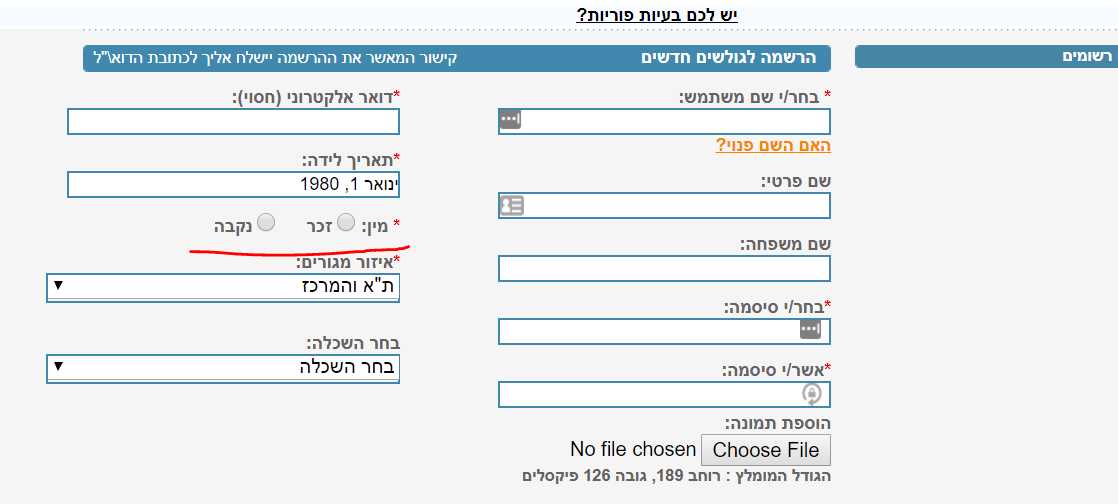

Absolutely, in English this never happens, in Hebrew software it is very common and is a huge factor in Facebook’s appeal. I doubt any software implements this as smoothly as Facebook, but it definitely wants to know early on so it can remove Robot Speak and feel more personal.
This is an example of a sign up page from http://www.tapuz.co.il/ that is supposedly the largest forum in Israel.
That is the signup page and it asks for gender and it is required!
The software they are using for discussing stuff is terribad and I find that in general with software used in Israel, however the gender stuff is solved cause you are forced to deal with that.
You kind of give your gender away anyway first time you ask a question cause you would say “Can you tell me (I am female) how to do XYZ?”. This stuff is embedded deep into the language.
Arguing this does not matter in Hebrew forums is kind of like arguing the pluralization does not matter. And it really does not, you can get away with 2 car/s everywhere, but it definitely makes the software feel worse.

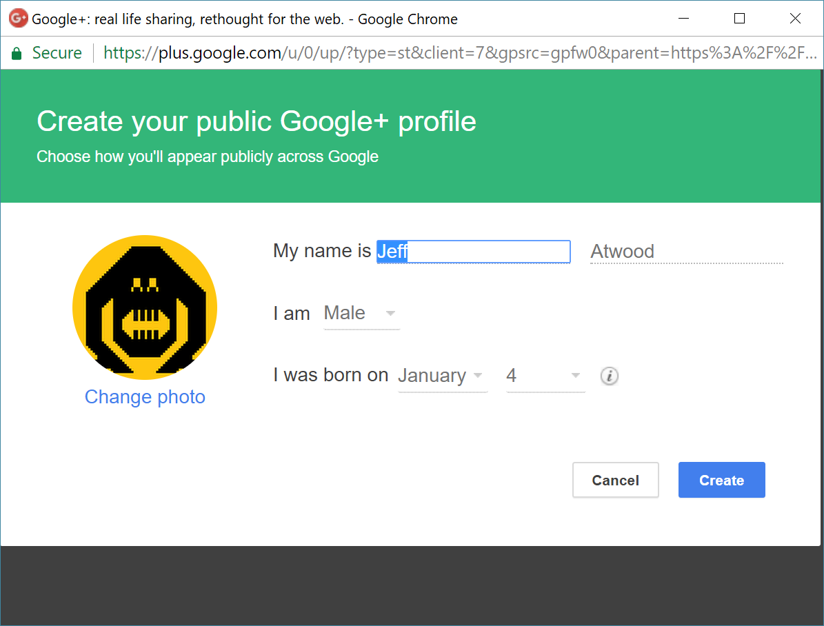

Still not super convinced this is really a forum thing across all cultures? Here’s what Google+ nags me about when I try to comment..
Asking gender and birthday immediately is crazy bizarre for a forum, but de rigueur for a social network..
In this case you are not really asking for gender though, you are asking for a user pref about how to render the site so it is sans robot speak, you may be male and prefer woman speak, you may be female and prefer male speak, or robot speak may be your thing
Clearly this stuff is optional and a feature for gendered langauages
