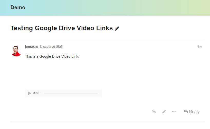

Just tested on try: https://try.discourse.org/t/testing-google-drive-video-links/876. It doesn’t appear to cause a download anymore, but the video player produced doesn’t work.

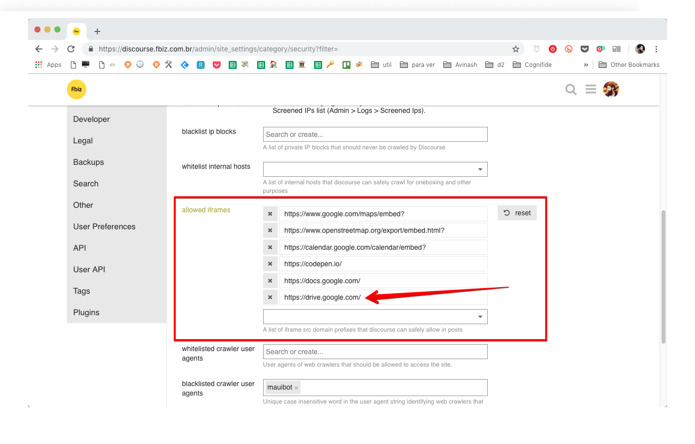

One workaround is to whitelist https://drive.google.com/ on Discourse settings:
Then embed video player iframe:
Then just paste it inside the topic in a new paragraph:
Take a look at this video explanation:
<iframe src="https://drive.google.com/file/d/[hash]/preview" width="640" height="360" frameborder="0"></iframe>

Per this post an embed does work if a) I whitelist the drive.google.com source domain AND b) I paste in the complete iframe HTML rather than the raw Google Drive URL.

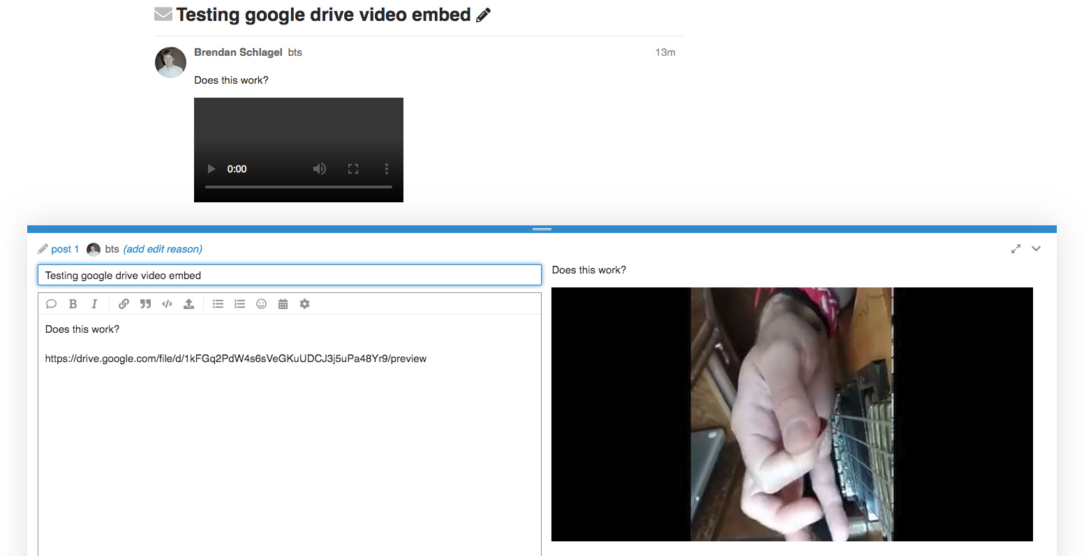

Also an issue that, as mentioned here, the video appears to display in the preview (actual thumbnail shows at least), but upon posting just shows the tiny blank non-functional preview. For example:

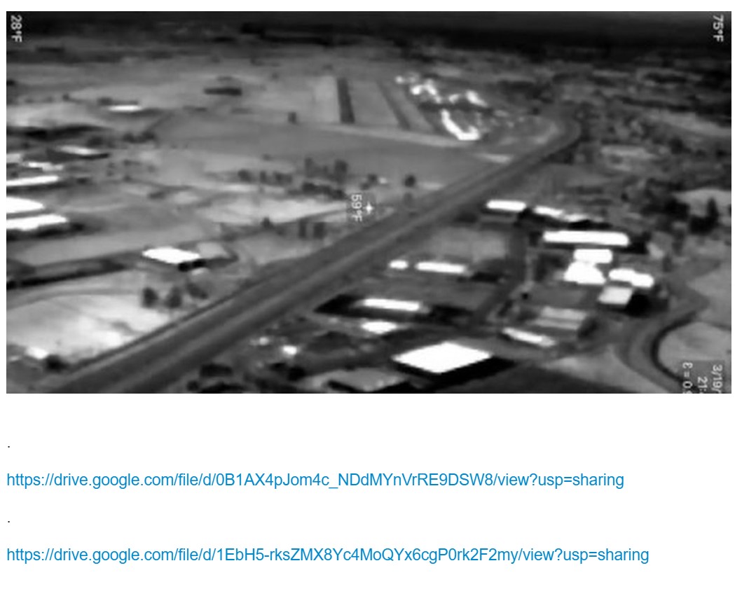

I am working on a new onebox engine to onebox Google Drive files. Right now here is how we see Google Drive links in preview:
The video preview doesn’t work once the post is created and the pdf and zip files doesn’t get oneboxed at all.
Here is how it will look after having google drive onebox engine in action:
