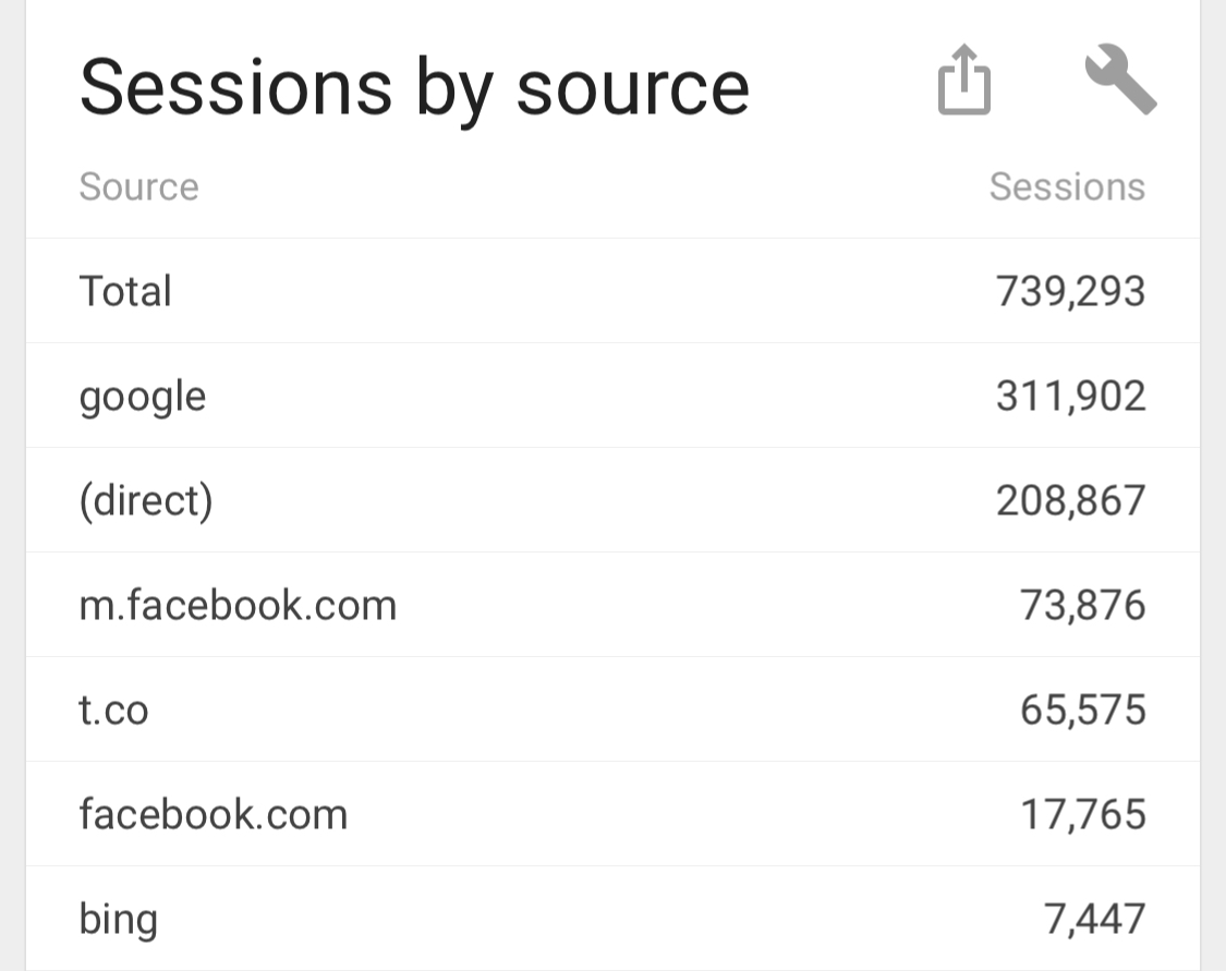

My data (se23.life) agrees:
About 1% of visits.
「いいね!」 5

I don’t think that only percentages should be considered. One of those 7,447 Bing users might be the one who starts the topic that gets a million page views.
