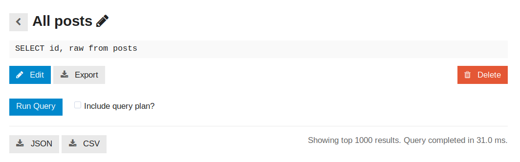

For a first phase, the result limit has been updated from 250 to 1000 and number of results is displayed via:
https://github.com/discourse/discourse-data-explorer/commit/316923f1906d811d8547cea99bde8e44d58dd15e
When the limit is reached, the UI indicates that only partial results are shown:
When the limit is not reached, the exact number of results is shown:
