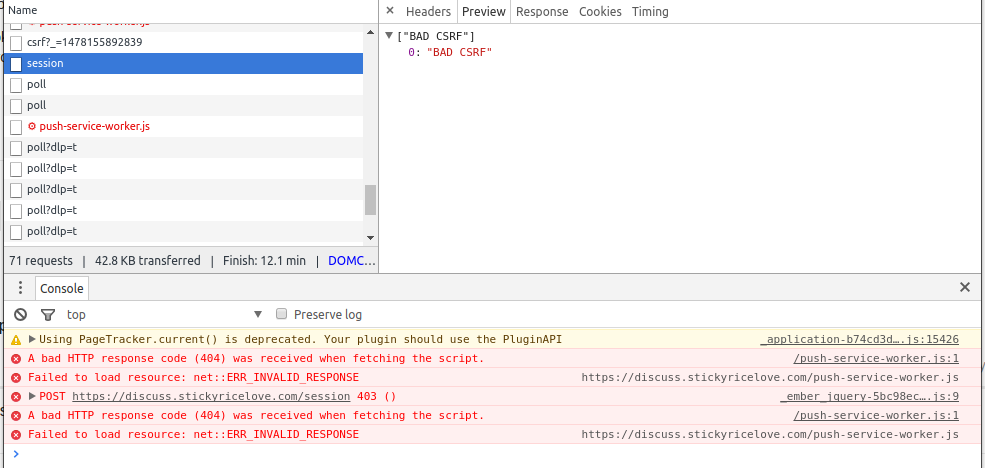

При любой попытке отправки формы входа появляется следующее сообщение, и мы не понимаем, что оно означает:

Do you have this behind cloudflare or anything like that? @sam do you see anything in the pictured JS console errors that would indicate what is the issue?

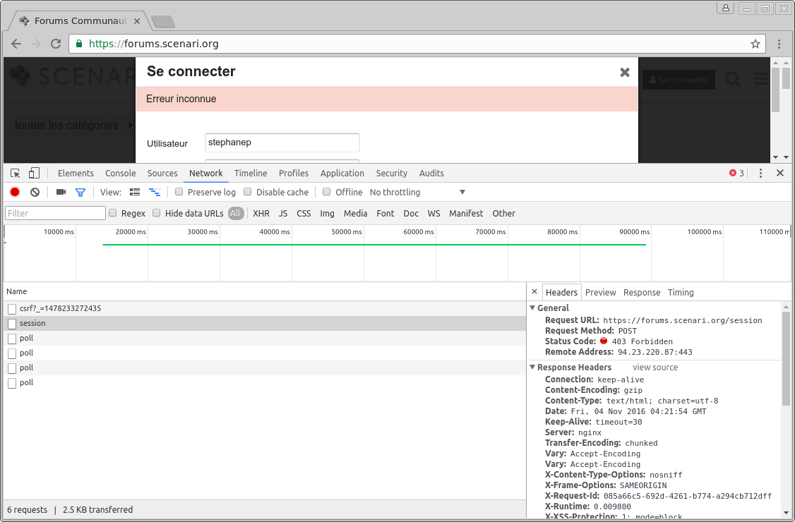

Hello,
I manage a small discourse forum for an opensource project and we have something that looks like the same problem. The error is exactly the same with google chrome, but is different with firefox : the login dialog works normally, the page is refreshed but it does not log me in (screenshots bellow).
It’s a dedicated host, and it doesn’t change much if I rebuild with beta, previous beta, or “tests-passed”. We don’t use cloudfare, but it’s behind a nginx reverse proxy (nothing too fancy). The discourse container is http, but nginx serves it in https through the reverse proxy, if that makes any difference.
I would appreciate any idea if there is something I can try.

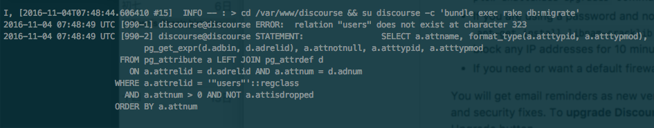

Мы пересоздаём VPS и устанавливаем свежую версию Discourse. Ниже приведено то, что произошло и привело к зависанию на некоторое время:

Hello. I tried to run it without the nginx reverse proxy and it did not resolve the issue. Will run a reinstall tomorrow except if anyone think about something that could help by that time.
I noticed that by default, the launcher rebuild script was checking out the “tests-passed” version. Is it a bit dangerous ? should it be beta ? When I update from the admin web screen, it update to the most recent beta instead ?
I had to launch a rebuild before the problem appeared because the host ip from inside the container changed. The host is also my mailserver, and the mail config was in app.yml.
Is it possible that with the rebuild, I updated to a version that somehow corrupted the config ? (I launched the rebuild around 11/02/2016 07:00 PM if that’s any help).

If you are running a reverse proxy 99.999% the issue is that you are not passing headers right to discourse.
