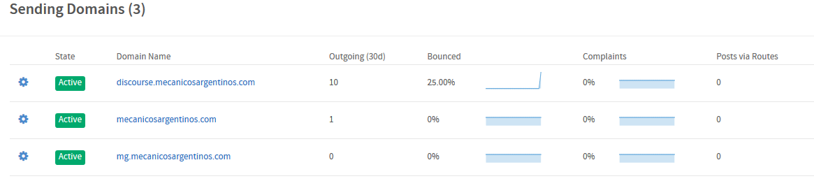

Below is a log from a subdomain; keep in mind that the attempts are from Outlook.

You have bounce rate 25% in your mailgun. It stops sending mail if bounce rate is above 5%. Contact mailgun support.
