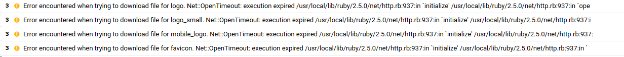

  1. I see that all the logos are gone, which I notice after seeing errors in logfile:
There some other quite strange errors in the log as well
imagen
I can see that this is a known issue so I proceed to reupload logos and everything seems to go back to normal, nearly.
