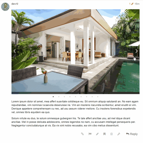

I have a working carousel which I would like to package as a theme:
I’ve been trying to figure out how to whitelist a class or attribute for the script to target that would work with under a theme.

The current selector I’m using to initialize the script on the container is:
$('.cooked>div[dir*="rtl"]')
So my question is:
How can I while-list a class or attribute for a div in a theme?
