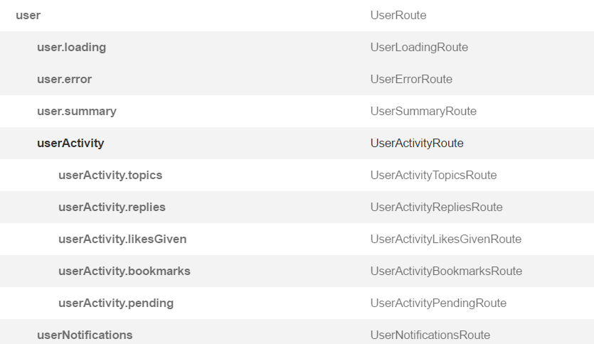

Yeah, I tried that but it fails to map right cause it is nested :
eviltrout
(Robin Ward)
29.Ноябрь.2016 18:10:29
Okay, I got this working although it meant a 100% rewrite of how my route map worked!
https://github.com/discourse/discourse/commit/4e251eaf080cb3d77eca843a47a8a950060d2564
Using what I suggested above (with a small change) will now work:
export default {
resource: 'user.userActivity',
map() {
this.route('solved');
