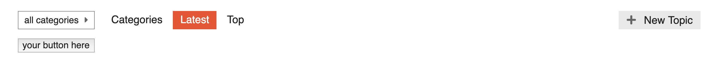

Is there an API to add new buttons next to or underneath the New Topic button - or where the New Topic button would go if logged out? I’d like to create an “Action” button with similar functionality to the Categories Button; when a user clicks it a dropdown should appear
I could definitely do it with jQuery, but I’d like to be able to switch out themes

Is there something like that but for the New Topic section?
You’d want to use a plugin-outlet for this, discovery-list-container-top would work.
<script type="text/x-handlebars" data-template-name="/connectors/discovery-list-container-top/custom-name">
  <button> your button here </button>
</script>
It would just take a bit of additional CSS to align it to the right instead of the left.
There’s more on handlebars templates and plugin outlets in Developing Discourse Themes & Theme Components
Thanks, that’s perfect!
