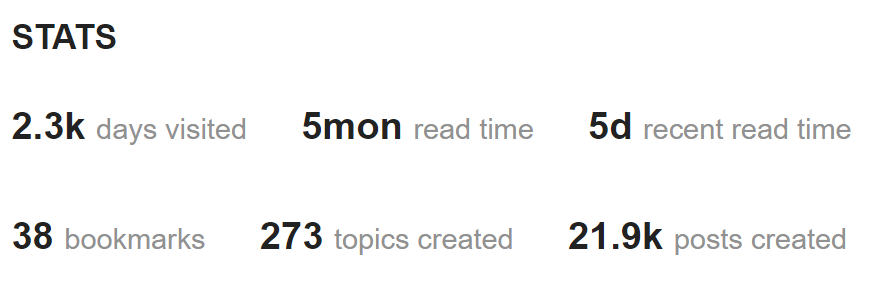

Isn’t this read data the backing store for these numbers, total read time?
Yes the “topic read time” I will update the OP to explain about that, I touched on it very lightly.
The topic_users table has a column called total_msecs_viewed. This number is updated independent of post_timings in the same controller action. We can not “rebuild” that number from post timings cause we have no idea about overlapping times.
The “topic timing” piece has no 6 minute limit like post timing does. The number is flushed with the same post timing batch according to the same rules.
I think I was so focused on talking about post tracking that I missed out on explaining the topic tracking part.
