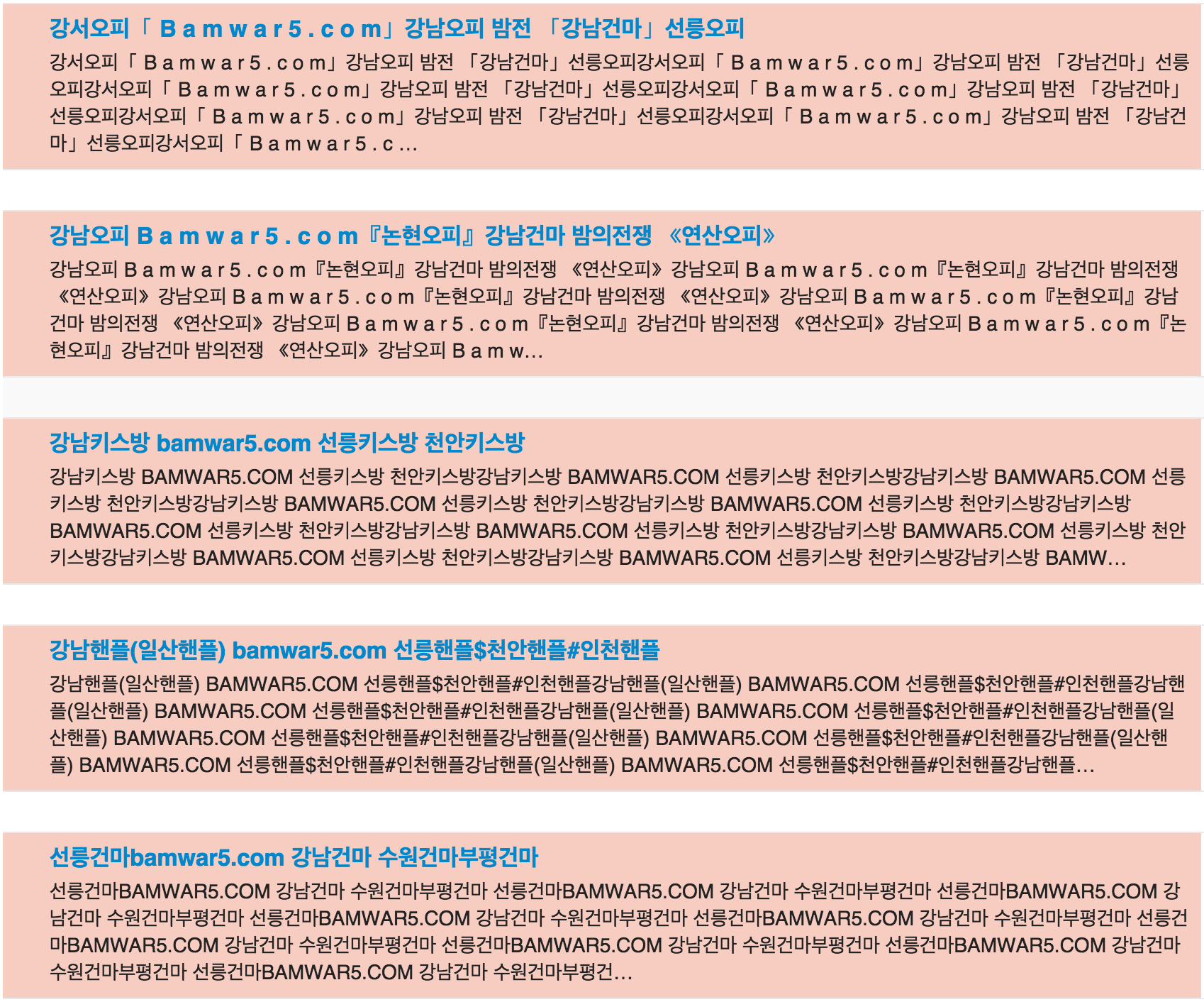

Since this morning, my Discourse is under a spam attack. They create a new account and post 5 messages.
I delete the spammer each time, but since they continue to create new accounts, I don’t know what to do.
Here the spams, maybe some of you get the same:
Thank you for your help

To be clear, these are human beings, so they will easily bypass any Capcha. You need the official Akismet plugin to block them based on Bayesian content filters.
(Can also block by IP, but they have a lot of IPs…)
I just installed the Akismet plugin and it already blocked the first spam :smile:

The Korean bamwar human spammers are still around and still pernicious enough to be effective even with fast typist and Akismet checking and new user post limits and IP limits. @sam will add language specific site settings (we need this for all uppercase checks and other stuff anyway) to make sure the common thread of Korean text is a huge red flag for a new user post.
This is something that comes up a fair bit, I am adding the feature to the 1.8 list
