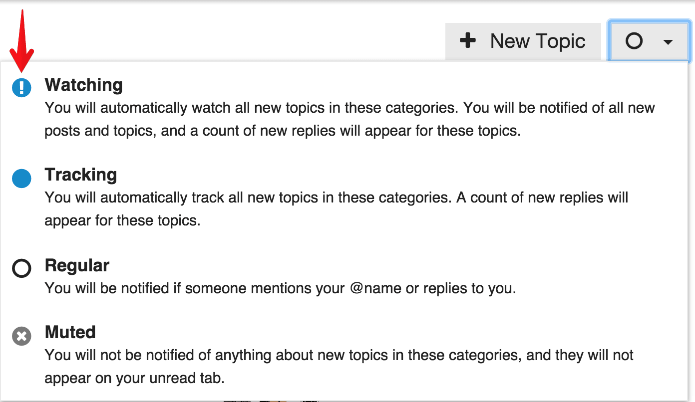

Is there a way to change tracking icons?
I’d like to try using loud-speaker as a base for all 4 icons. The circle makes little sense and I notice that my users never click there and don’t know what is that for. I think a different icon would bring their attention.
I’d be tempted to put a picture of a letter on Watching, since that’s what we use to indicate “yes, you’ll get emailed on this category/topic”
now that I think about it… there’s nothing really alarming to indicate a ! in the first place.

This leaves me with envelopes for topics which will get you emailed (watching), and a chat bubble for topics which will just notify you (tracking).
I don’t know how to put a blue circle around the envelope, but I think this is a great improvement over the Exclamation point.
