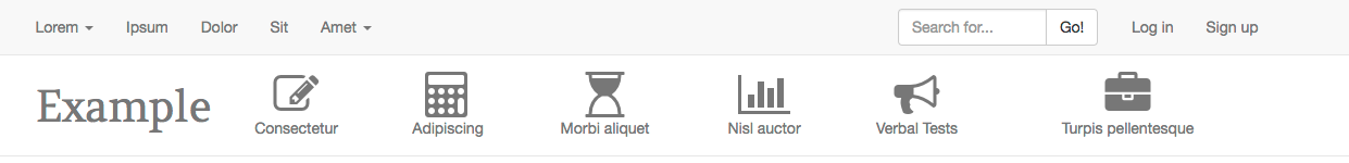

Estou tentando criar um plugin que altere o cabeçalho para algo assim
Não importa muito como ele fica visualmente; o importante é que não quero usar personalização no caminho /admin/customize/css_html. Quero criar um plugin que mágicamente altere tudo o que preciso.

Based on the screenshot, this seems like something that is plausible to do with just CSS customizations. That would also be much simpler than writing a plugin and would not require updating with new versions of Discourse code.
Well, I knew you going to say that, that’s why I mentioned that I need a plugin :slight_smile:
First of all, because I want to learn how to do plugins, I’ll have to do whole lot more complicated things later. That menu is just an example.
Secondly, I really need that menu to be a plugin, because:
