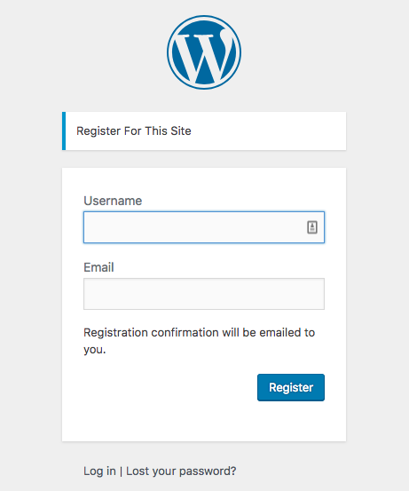

By ‘default WordPress login’ I mean that users are creating an account on a page that looks like this:
If this is the registration process you are using, then users should not be having to verify their email address before first logging into Discourse.
There are quite a few front-end registration plugins for WordPress that will create an account and automatically login a user without requiring the user to verify their email address. Woocommerce is an example of a plugin that does this. This can be a security risk for Discourse.
