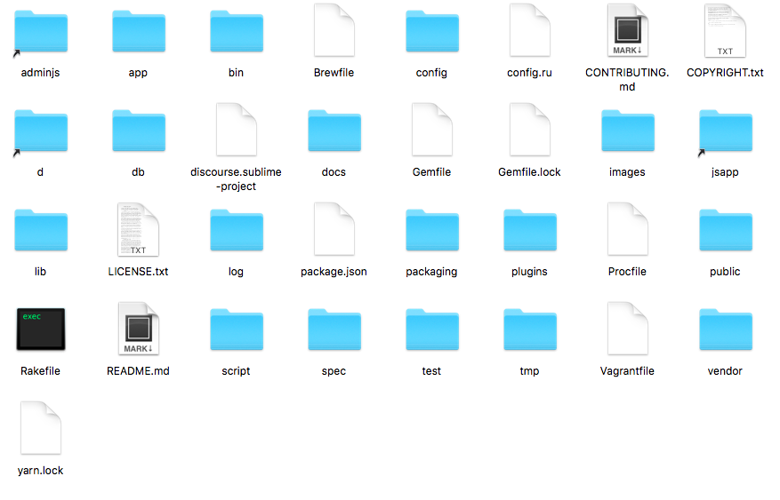

I was now able to follow this guide:
I would like to edit and see if I was able to add some changes to: https://github.com/discourse/onebox/blob/master/lib/onebox/engine/amazon_onebox.rb
But Im not able to find the file on my mac?
Damn it have a steep learning curve this thing…

techAPJ
(Arpit Jalan)
1 مارس 2018، 8:34ص
7
To edit onebox files, you need to clone source code for onebox gem.
frold
1 مارس 2018، 8:37ص
8
techAPJ
(Arpit Jalan)
1 مارس 2018، 8:39ص
9
That was for cloning discourse core repo. If you want to hack on onebox gem, you will need to clone the source code for that gem as well.
frold
1 مارس 2018، 8:43ص
10
Okay, then I dont know anything…
What is the difference of a dev box and a running site then?
I thought setting up a dev box I would be able to edit files…
Seems now I need to follow another tutorial…?
This is only for very technical users, like in very - I give up
You have the core files and then you have various modules that discourse rely on - some developed by discourse and some not. Onebox is one of those modules.
