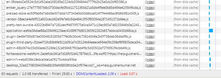

As far as I know, all emojis are lazy loaded.
Have you checked your browser console’s network tab to see if it is discourse or your web server is the culprit?
I am not saying, it doesn’t load. It loads, but very slowly till you would already decide I don’t want to use emoji now. Because, searching for right emoji becomes difficult.
I will try to debug Console to see if there is any issue.

Can you please refer to this video, this is what exactly I am facing.
https://www.useloom.com/share/357e7637517346cdb6b7242e93606c04
I can see the issue this is actually not network related.
