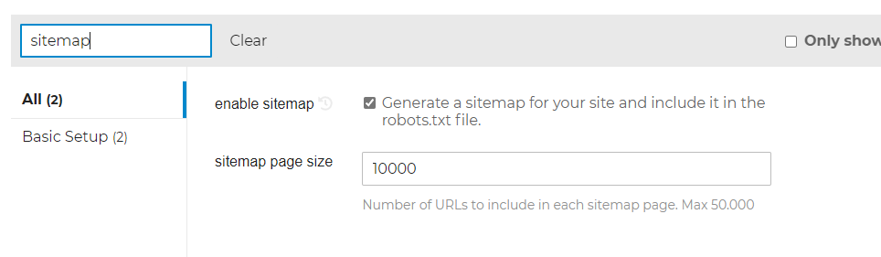

In discourse settings I enable sitemap:

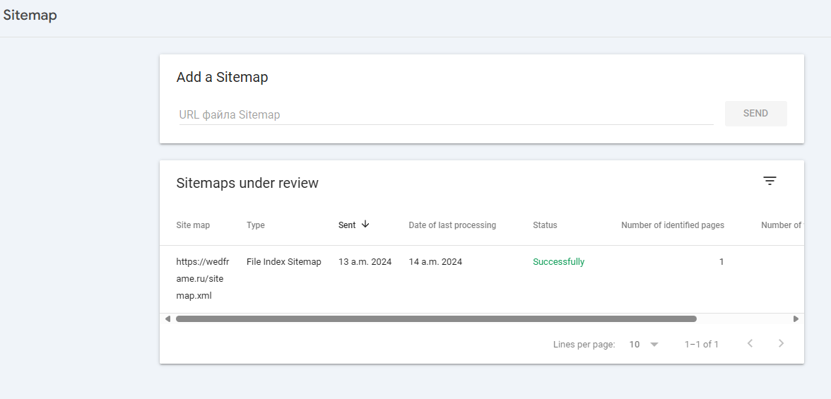

I add this sitemap to GSC and looks like this file was succesfull imported, but it always show only one founded page:

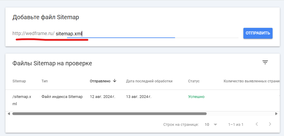

I fill the form on GSC, like this:
and I think its mean what domain name was included.
The same way I try to add sitemap_1.xml:
and it did’t work.

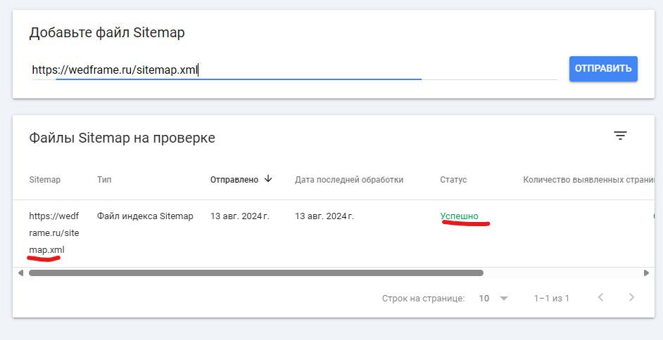

Try with httpS
https://wedframe.ru/sitemap.xml
Thanks again, David! Did’t know what in GSC need add separate http and https. I was add this domain to GSC many years ago, when certificates were practically not used anywhere. Apparently for this reason it was impossible to use the httpS address in the sitemap adding form. But that’s not a problem. Now I’ve added my resource again, and now I can use httpS in this form.
However, at the moment, this also does not solve the problem. When I open the processing data of this file, I see two other sitemap files. And the one what containing all the topics and categories still does not import due to an error:

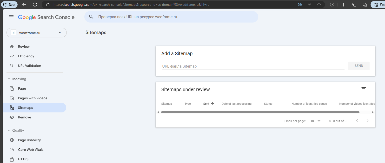

Ok. I delete sitemap:
and send one more time:
Google say - it’s all right
And now then when I click on this newly sended sitemap.xml, I see two new files and theres steel one file with error “Not received”
