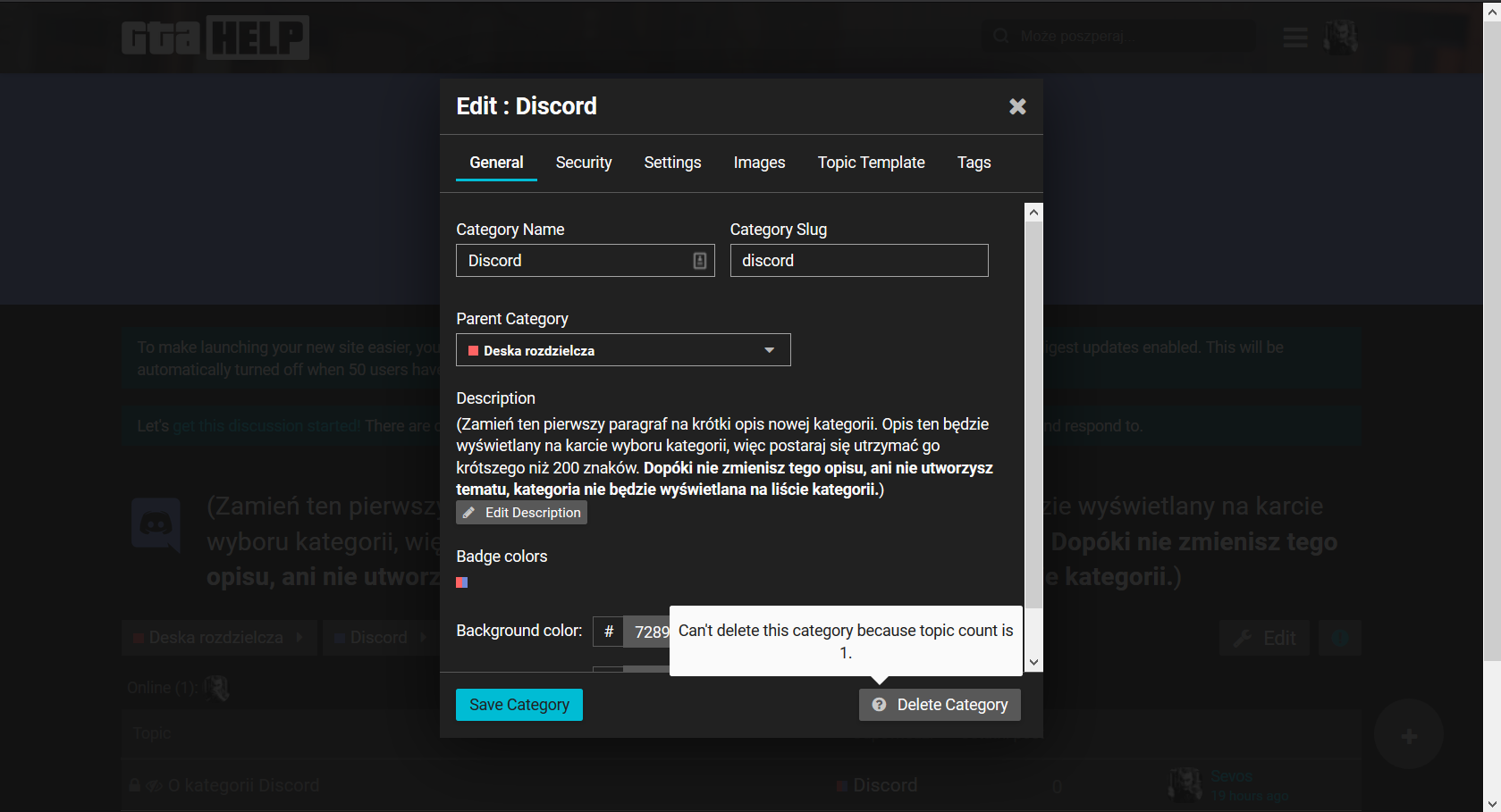

When I try to delete a category, I get this error: “Can’t delete this category because topic count is 1.”. Okay, gotcha.

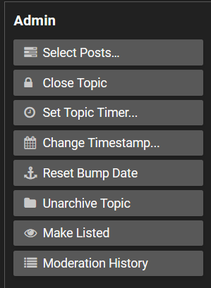

Topic seems to be archived but not closed. Maybe you need to “Unarchive Topic” or “Close Topic” before you can delete it?
The javascript error might require a full page reload to go away.
Another way would be to move the topic somewhere else so your topic count goes to zero.
Okay, it’s no longer archived and i closed this topic. I tried also move this to the another topic. Nothing helped :confused:

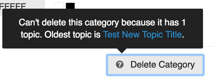

Deleting the category from the rails console could have bad side effects, it would be better to delete the remaining topic from the user interface. The “About this category” topic cannot be deleted, and does not count towards the “topic count is 1” message. There must be another topic in the category.
When you click “delete category”, you should see a message like this with a link to the remaining topic:
Do you see that?
Yeah, that’s what I see:
obraz
That message doesn’t look the same as the one I put a screenshot of…
