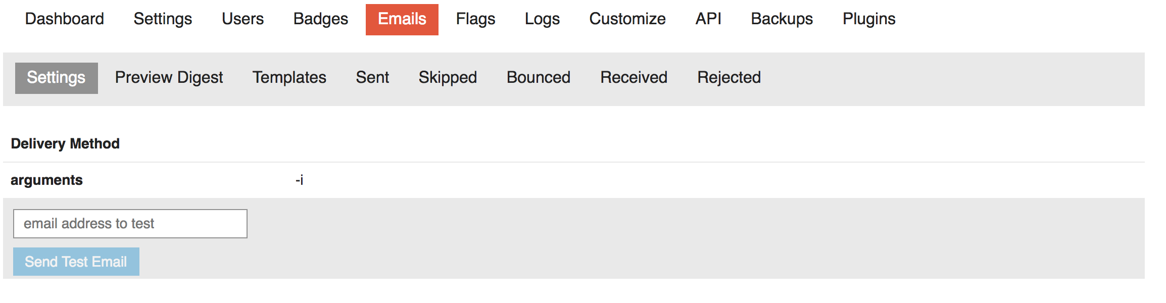

I cant see any delivery method information this screen. Is this normal?

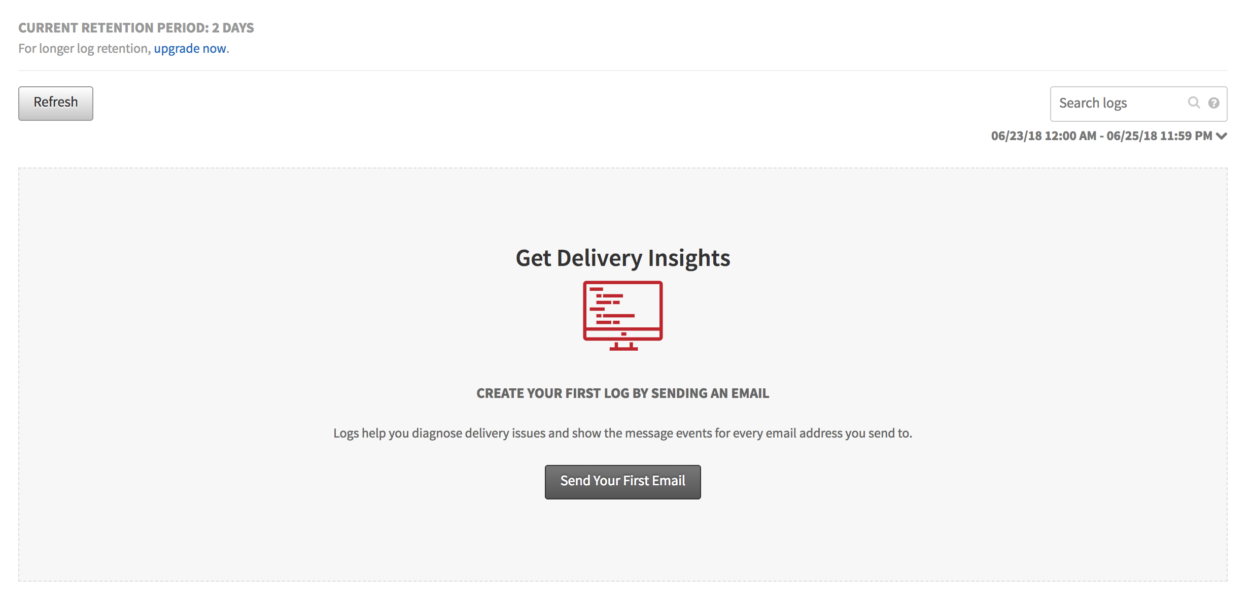

Look at the mailgun logs.
nothing seems :frowning:

No. That is not normal. Did you use discourse-setup to configure SMTP?
Why can’t you use discourse-setup? There are many conditions in which you can’t use it (e.g., you’re running on a non-standard port). From some of your output it’s clear that your app.yml isn’t configuring SMTP correctly, if at all.
No, there is no requirement for using discourse-setup, but since you’re apparently unable to configure app.yml without it, that was my suggestion.
