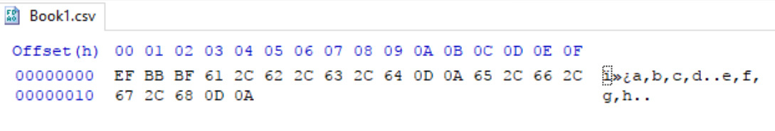

That might make sense @techapj I can confirm via hex editor, when Excel 2016 file is saved as CSV
a,b,c,d
e,f,g,h
there is the BOM marker by default:
UTF-8 EF BB BF
