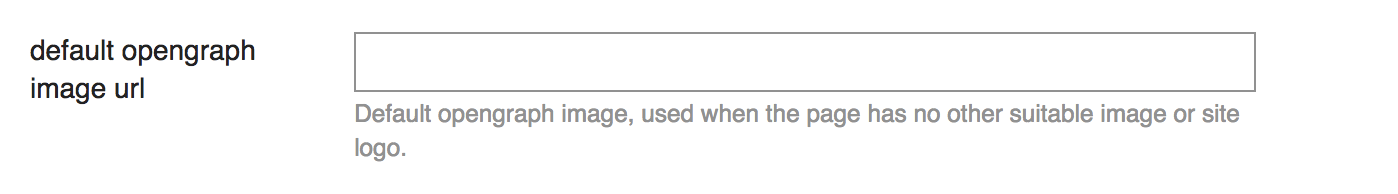

As a matter of interest, have you added a link to the default opengraph image url setting?
1 « J'aime »
Thank you for that hint, @robmc!
This field was indeed empty. So I have added the link there, and will now fix LI post.

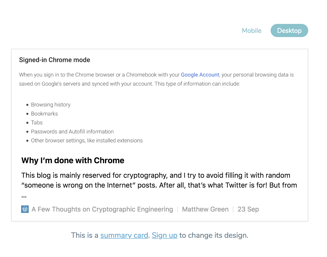

To be honest, it looks like there is something amiss on your blog setup
It seems that Discourse renders the image fine, but if you test the blog post with iFramely there are some odd results. You might want to search there before changing too many things on Discourse
3 « J'aime »
The result that is shown is actually correct after the edits I made (sort of). The ‘Signed-in Chrome mode’ comes from the og:image in the second link that used to have a link preview.
Since my post does not have link previews anymore I expected the og:image to fall back to the default specified in Settings, but it kept the image from the last link preview that I removed.
Also, this image has once again changed, and on iFramely it is now showing a different image than the one you posted. But this is the one I actually wanted. BTW, I test open graph with https://opengraphcheck.com/
