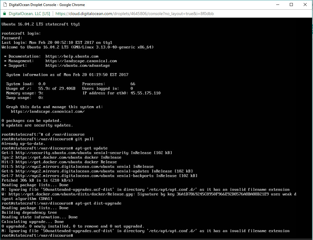

The forum is down and when I try to upgrade docker I get this error:
./launcher rebuild app doesn’t work, as it was what made the forum go down in the first place (maybe a bad upgrade procedure?). I’m afraid the docker install is corrupted somehow and the data is lost. I have regular backups, but I still don’t want to lose what I had.
I think the “ignoring file…” bit is a red herring and not at all related to the problem. /etc/apt/apt.conf.d/50unattended-upgrades is a regular Ubuntu file. It does not regularly have .wcf-dist tacked on the end. That probably means the file was modified, and the distribution version was saved with a “disarmed” filename.
Your packages are up to date and your git files are up to date. The lack of the docker0 device is mildly alarming. If it were my box, I’d probably reboot and try the launcher again.

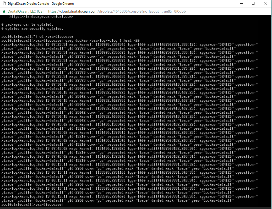

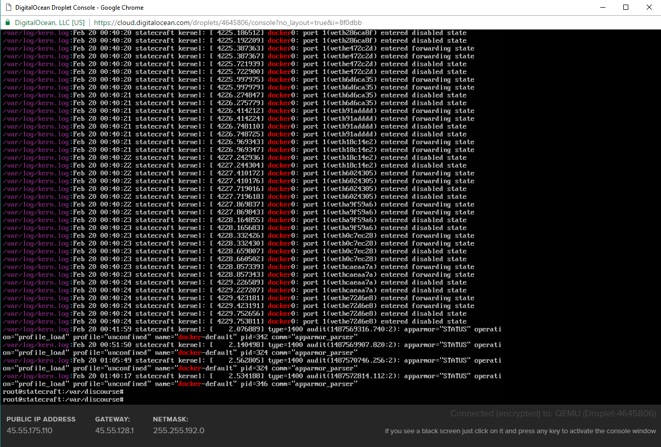

Does grep docker /var/log/*.log show errors or warnings?
Here’s what I get:

@zcalbrecht That’s a lot of stuff. The interesting bits probably scrolled off. Try it with head, eg:
grep docker /var/log*.log | head -20

The log has rotated out. Previous errors ended in the 4000ish seconds since reboot, this is in the 130,700ish seconds. I don’t know enough about Docker / Apparmor interactions to know if that is a harmless set of messages or not.
