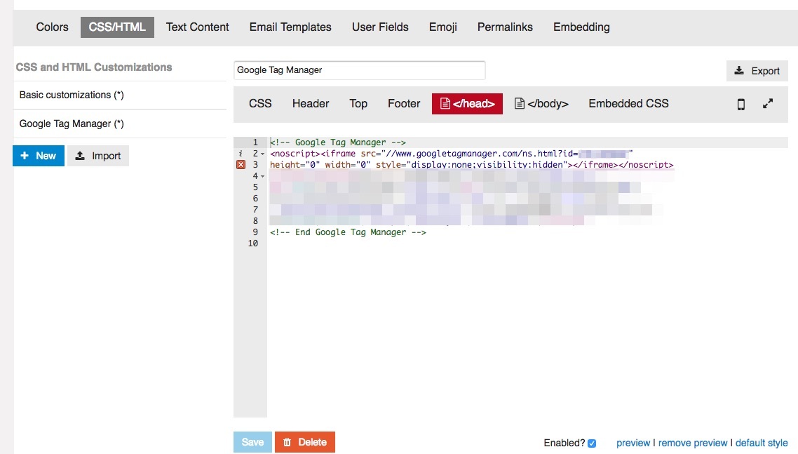

I was playing around in the admin panel and figured this out.
In Admin > Customize > CSS/HTML - Create New
Give your customization a name - then click on Header. Paste your Google Tag manager code there. This will be placed just after the opening tag as recommended by Google.
Make sure you delete your Google Analytics tracking from the setting area if you use Tag Manager to track analytics.

@shri @neil i put in header http://localhost/admin/customize/css_html/2/header as per GTM instructions js code should be just after body tag.

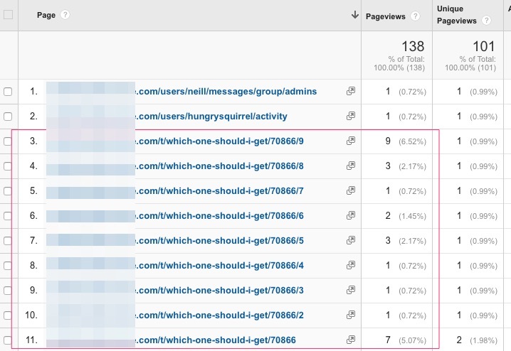

You’re saying that isn’t happening? I’ve been given this screenshot that suggests it is:
That site also has the discourse-adplugin installed, which uses the googletag api, so maybe the DFP api is doing the work for gtm analytics.
If that’s the case, then the discourse-adplugin could also become the google tag manager analytics plugin.
