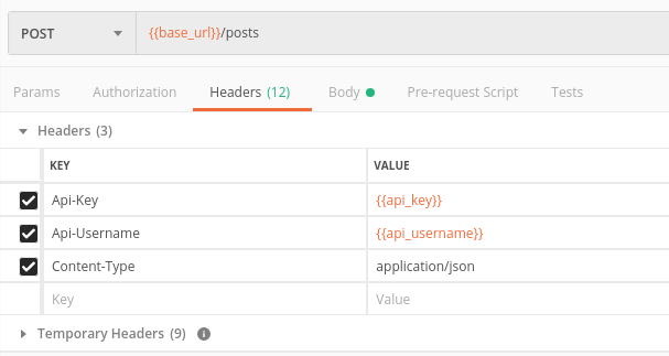

Can you share with me your actual ruby code to make this request? I’m unable to reproduce this locally. Here is the Postman json call I’m making and I’m always getting a response back:
