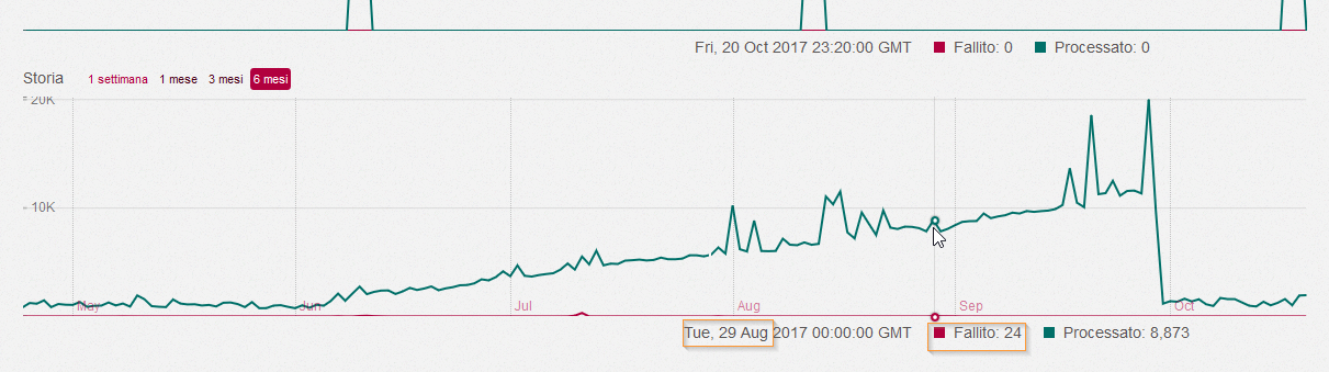

For example, looking on the dashboard and set the stats for 6 months I can see this graphic:
The chart tends to rise steadily and after about 20000 processes it seems to reset and start over again.
