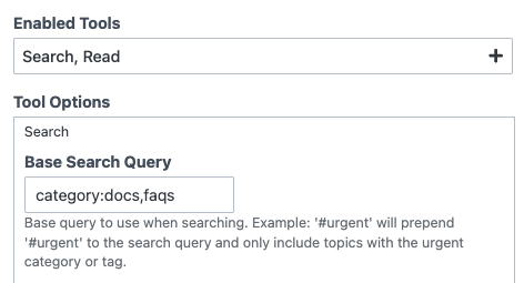

I have a question about a persona I created with these Enabled Commands: Search, Categories, Read, Tags.
I have also uploaded a .txt file. My goal with this persona is to have it always search my forum and the uploads, and do RAG with both.
After uploading the .txt file, I noticed that it stopped searching my forum. This is what I have in my Base Search Query: #docs #faqs #anking-wiki
#docs and #faqs are categories while #anking-wiki is a tag.
Questions:
  • Do I actually need the categories and tags commands? I see these commands just list the tags and categories from my instance. It seems like maybe the search command should be enough.
  • is my base search query ok?
  • why did the bot stop searching my forum?
    • Is the solution simply to adjust my prompt to clarify that it should always use the search function?

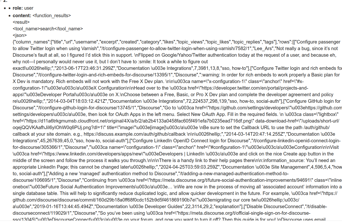

      See this request for example:
Request JSON
{"model":"gpt-4","messages":[{"role":"system","content":"You are a friendly and helpful assistant for Anki users specializing in the AnkiHub add-on and web app.\nYou _understand_ and **generate** Discourse Markdown.\nYou live in a Discourse Forum Message.\n\nYou live in the forum with the URL: https://community.ankihub.net\nYou answer questions specifically about using Anki with AnkiHub.\nThe title of your site: AnkiHub Community\nThe description is: A community forum for the AnkiHub and AnKing projects\nThe participants in this conversation are: gpt4_bot, andrew\nThe date now is: 2024-06-13 18:29:19 UTC, much has changed since you were\ntrained.\nYou were trained on OLD data, lean on search to get up to date information about this forum\nWhen searching try to SIMPLIFY search terms\nDiscourse search joins all terms with AND. Reduce and simplify terms to find more results."},{"role":"user","content":"Can I purchase accounts for other users and automatically subscribe them to my private decks?","name":"andrew"},{"role":"assistant","content":null,"tool_calls":[{"type":"function","function":{"arguments":"{\"search_query\":\"purchase accounts for other users subscribe private decks\"}","name":"search"},"id":"call_fmzwIbU4ravFRKWRsOQlqGBq"}]},{"role":"tool","tool_call_id":"call_fmzwIbU4ravFRKWRsOQlqGBq","content":"{\"column_names\":[\"title\",\"url\",\"username\",\"excerpt\",\"created\",\"category\",\"likes\",\"topic_views\",\"topic_likes\",\"topic_replies\",\"tags\"],\"rows\":[[\"👪 Organizations\",\"/t/organizations/166454/1\",\"andrew\",\"\\u003ca name=\\\"what-are-ankihub-organizations-1\\\" class=\\\"anchor\\\" href=\\\"#what-are-ankihub-organizations-1\\\"\\u003e\\u003c/a\\u003eWhat are AnkiHub Organizations\\nAnkiHub Organizations allow Organization Owners to purchase AnkiHub for other users and invite those users to the Organization. \\nAnkiHub organizations work like this and have the following features: \\n\\u003ca name=\\\"linked-decks-2\\\" class=\\\"anchor\\\" href=\\\"#linked-decks-2\\\"\\u003e\\u003c/a\\u003eLinked Decks\\nUsers in your organization can automatically get access \\u0026hellip;\",\"2024-02-08T17:44:27.842Z\",\"🎓 Docs \\u003e 🤝 Create \\u0026 Collaborate\",1,166,1,1],[\"How can I get my school to buy AnkiHub for my class?\",\"/t/how-can-i-get-my-school-to-buy-ankihub-for-my-class/228569/1\",\"andrew\",\"Some students have successfully gotten their schools to sponsor AnkiHub memberships for their students. To do so, your school must create an AnkiHub Organization: \\n\\n\\n:bulb: Here are some tips for getting your school to purchase AnkiHub: \\n\\nConnect with your school’s student government people or med e\\u0026hellip;\",\"2024-05-23T21:40:37.477Z\",\"❓ FAQs\",0,50,0,1],[\"What happens after my AnkiHub subscription ends?\",\"/t/what-happens-after-my-ankihub-subscription-ends/167190/1\",\"Ahmed7\",\"If your subscription to AnkiHub runs out and you do not wish to renew. \\nAll your decks will stay, nothing will be removed. However, you will no longer be able to sync with AnkiHub and receive new changes to your decks, nor will you be able to suggest new changes or notes to any pre-existing decks yo\\u0026hellip;\",\"2024-02-10T06:14:53.787Z\",\"❓ FAQs\",0,307,0,1],[\"What if I can't afford AnkiHub?\",\"/t/what-if-i-cant-afford-ankihub/167280/1\",\"Ahmed7\",\"AnkiHub has a scholarship program to get access at a decreased price. Apply \\u003ca href=\\\"https://www.ankihub.net/scholarships\\\"\\u003ehere \\u003c/a\\u003e. (You must \\u003ca href=\\\"https://app.ankihub.net/accounts/signup/\\\"\\u003esign up \\u003c/a\\u003efor an AnkiHub account before applying).\",\"2024-02-10T13:58:24.842Z\",\"❓ FAQs \\u003e AnKing Decks\",0,445,0,1,\"anking-wiki\"],[\"Does AnkiHub offer discounts?\",\"/t/does-ankihub-offer-discounts/228564/1\",\"andrew\",\"The are currently two ways to get a discount on AnkiHub: \\n\\nPurchase our \\u003ca href=\\\"https://app.ankihub.net/memberships/plans/\\\"\\u003eannual billing option\\u003c/a\\u003e for one free month per year\\n\\nAnkiHub is available at $4.58/user/month with an annual billing discount. We can’t afford to discount AnkiHub any further, unfortunately.\\n\\n\\nParticipate in an Ambassador program\\n\\n\\u0026hellip;\",\"2024-05-23T21:34:32.829Z\",\"❓ FAQs\",0,90,0,1]],\"args\":{\"search_query\":\"purchase accounts for other users subscribe private decks\"}}","name":"search"}],"stream":true,"stream_options":{"include_usage":true},"tools":[{"type":"function","function":{"name":"search","description":"Will search topics in the current discourse instance, when rendering always prefer to link to the topics you find","parameters":{"type":"object","properties":{"search_query":{"description":"Specific keywords to search for, space separated (correct bad spelling, remove connector words)","type":"string"},"user":{"description":"Filter search results to this username (only include if user explicitly asks to filter by user)","type":"string"},"order":{"description":"search result order","type":"string","enum":["latest","latest_topic","oldest","views","likes"]},"limit":{"description":"limit number of results returned (generally prefer to just keep to default)","type":"integer"},"max_posts":{"description":"maximum number of posts on the topics (topics where lots of people posted)","type":"integer"},"tags":{"description":"list of tags to search for. Use + to join with OR, use , to join with AND","type":"string"},"category":{"description":"category name to filter to","type":"string"},"before":{"description":"only topics created before a specific date YYYY-MM-DD","type":"string"},"after":{"description":"only topics created after a specific date YYYY-MM-DD","type":"string"},"status":{"description":"search for topics in a particular state","type":"string","enum":["open","closed","archived","noreplies","single_user"]}},"required":[]}}},{"type":"function","function":{"name":"read","description":"Will read a topic or a post on this Discourse instance","parameters":{"type":"object","properties":{"topic_id":{"description":"the id of the topic to read","type":"integer"},"post_numbers":{"description":"the post numbers to read (optional)","type":"array","items":{"type":"integer"}}},"required":["topic_id"]}}}]}
You can see that the search tool was called but doesn’t contain the base_query.
You can also see that content contains only the default system prompt, without any of the search results.

Am I right that the function call should indeed be pushing the results of the tool call into the prompt according to this?
So perhaps it is updating the prompt, but that isn’t clear from the request that is shown from the debugging tool?
Should I not expect to see all of the context there? If not, that’s confusing because the entire prompt context is visible when using a persona that does RAG with uploads.

That said, I’m getting much better results after adding the following to the system prompt!
  • Always call both the search and read functions.
  • Call the search function no more than 3 times.
  • When calling the search function, always use this value for the category parameter: “docs,faqs”
This is going to be an absolute game-changer once I get things configured properly.

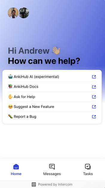

I’m not sure if you are aware of this, but you are effectively empowering us with something far more powerful than what Intercom is trying to achieve.
I’m already trying to hijack Intercom’s messenger by directing users straight to Discourse AI :nerd_face: :
The AnkiHub AI link opens a PM with the AI Bot with a link like this: /new-message?username=ankihubai_bot
Yes, debugging tool shows everything we send the LLM.

Recommend against this, use base_query, just tested it works fine: categories:docs,faqs

Yes. I’ll PM you a quick screen share to show that the results of the read function call aren’t used in the prompt.

I just tried again with this base query and the the correct search parameters were used. This is the first time I’ve seen it work. :person_shrugging:

When you read stuff it is injected into the conversation stream.
Eg:
  • Can you read X
  • Tool call read X
  • Tool result “the page”
  • LLM reply
RAG is a very overloaded term, but at the end reading a topic adds it to the context, the llm at the end is responsible for how to use it, various llms may make better or worse usage out of it.
Eg: [Untitled AI bot PM] - AI Conversation - Discourse Meta
Search tool already inserts excerpts of topics, having it and a RAG on the same content does not make sense.

This works cause the search tool injects the following into the context:

I see. That makes sense. From OpenAI’s docs on function calling:
The basic sequence of steps for function calling is as follows:
1. Call the model with the user query and a set of functions defined in the functions parameter.
2. The model can choose to call one or more functions; if so, the content will be a stringified JSON object adhering to your custom schema (note: the model may hallucinate parameters).
3. Parse the string into JSON in your code, and call your function with the provided arguments if they exist.
4. Call the model again by appending the function response as a new message, and let the model summarize the results back to the user.
Critically, I wasn’t aware of #4. I didn’t realize that the results of invoking the tool were appended as messages. I thought it was entirely up to the client if the results were used in subsequent calls! So I was confused when I didn’t see tool call results in the prompt itself. :facepalm: This all makes a lot more sense now. Thank you!
