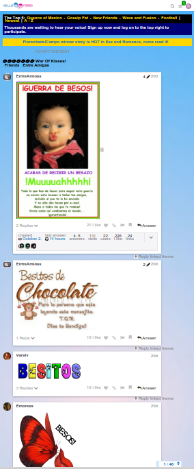

To clarify: is this one of the topics you want to remove from Top?
If so, then it sounds like you will need explicit manual curation. The like counts on every post are very high.
http://www.helloforos.com/t/guerra-de-besos/27555
