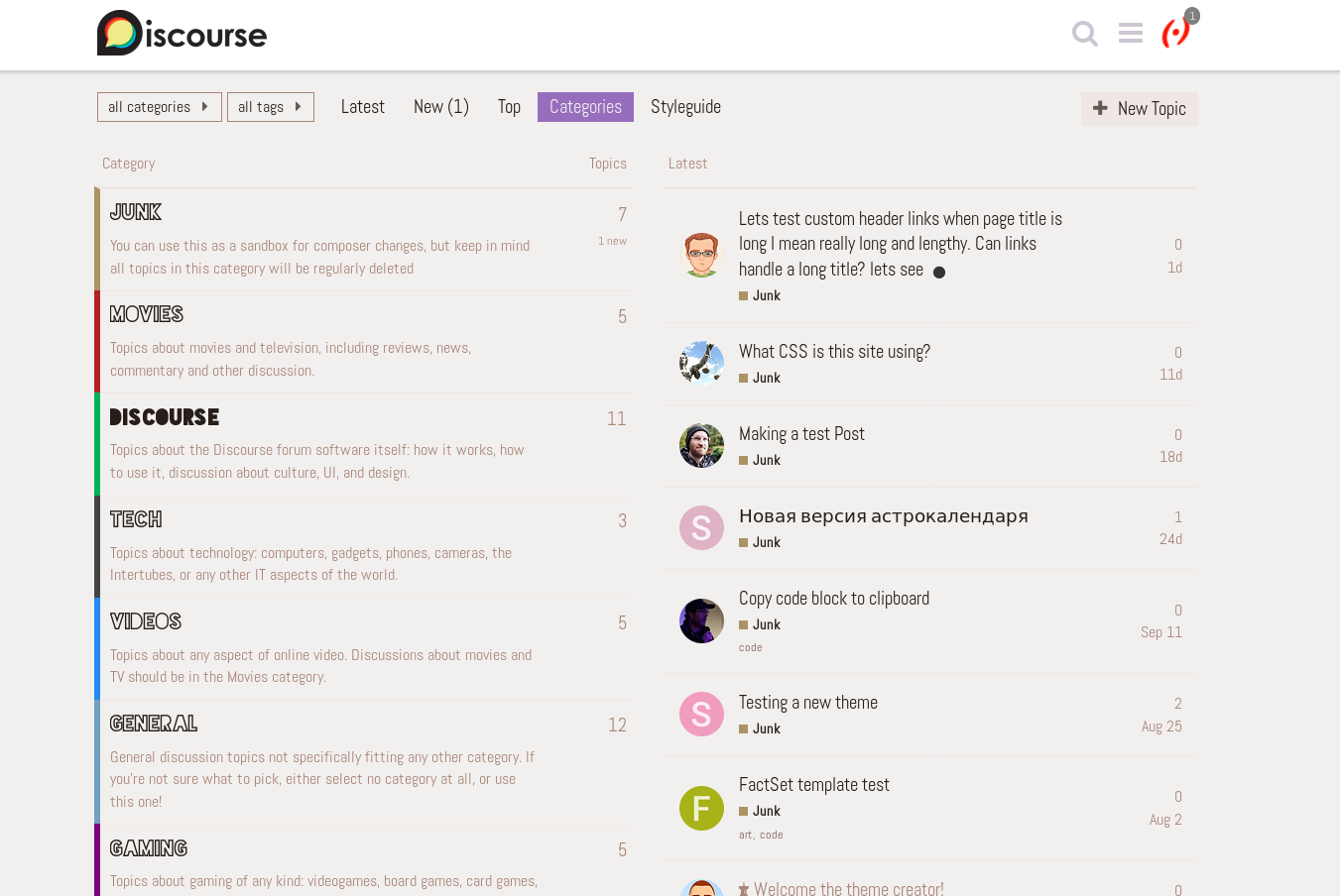

Hello there,
I started developing a – my first – theme for https://talk.incommon.cc that you can preview on the theme creator.
It’s not yet used on IN COMMON because I need to fix the JavaScript. Help and pointers welcome!
Here’s a screenshot:
Hello there,

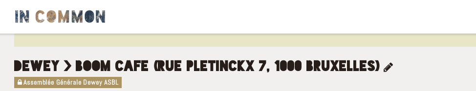

Here’s an example bug:
We can see the title has been converted to unaccented characters (on café).
But then when we scroll, the title moves to the banner, and this event is not covered by the stripAccentsFromTitle function
Does anyone have a pointer to a list of appEvents and how to use them?
